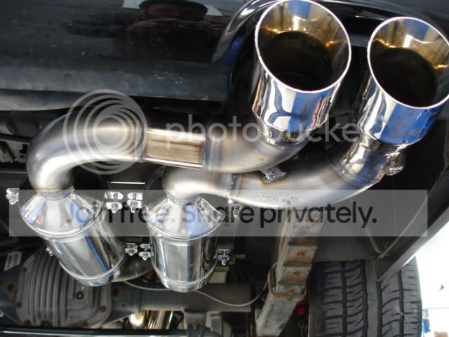

These are Aeroturbines . They sound good and take ouit the drone
Steve, I can't tell from the picture...but I assume you have added the aeroturbos to your muffler (Magnaflow???)...or are these two aeroflows the only mufflers you have?

Yes your assumption is correct. They are downstream of the BB muffler. I have removed the spare tire to perform this installation ala Belgium Barry:D
