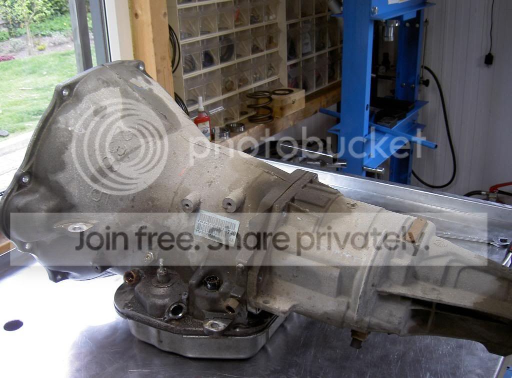

when my 2nd gear was out , the other gears where fine , band adjust didnt help anymore because the drum that stops first gear was gone...
did a rebuild and see what came out...
now after the rebuild with upgraded parts , the truck drives and shift better than it was brandnew...:rock:

The pic of the wear on the drum suggests otherwise.
i know sir , bud i dont lie , i even did witness the adjustments every time in the shop , i even had the band-adjust-manual from Tony (jtsv).
I'm not saying you are lying. The wear looks pretty severe which is why arrestmered04 said it was due to band adjustment. Either way your truck is in much better shape now. :D
