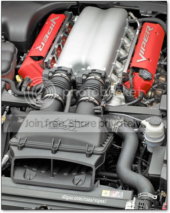

08' Viper Engine
You will need some custom throttle bodies since the new engine is drive-by-wire. New intake manifold is also two piece with an upper and lower plenum.
