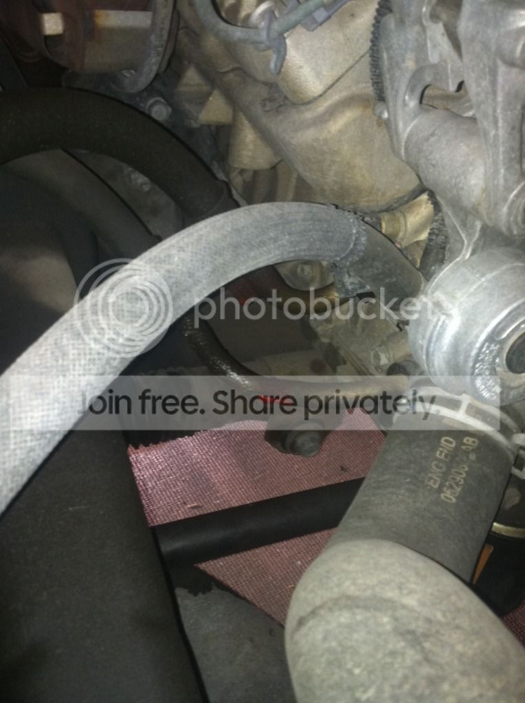

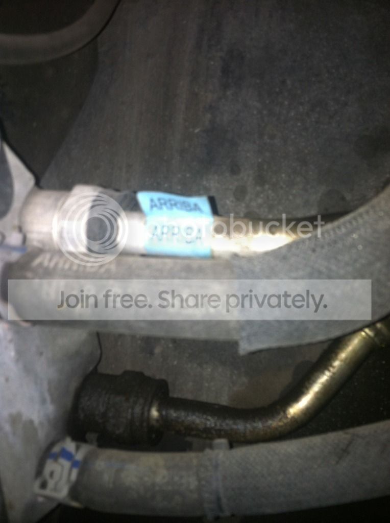

so i was looking at the service manual and cant seem to find what these hoses are for. they go right above the oil filter to a hub and seems to return. im guessing its a oil sennor of some type. im not sure though, i was trying to figure out if i can swap out these hoses myself or its something a dealership would have to do. does anyone know the name of these type of hoses so i can pick these up and do the swap. looks like it would be a easy swap to do.
arnt those the oilcooler lines ?
Tony at JTSVenom has update version of these lines.;)
I finished replacing mine about 10 minutes ago. The job will be much easier if you obtain lines that utilize the factory quick disconnect clips.
no quality replacement lines come with the standard sub-standard P.O.S. quick connect factory ends:rock:
Really? Then where did I get these?

not sure. can't make it out real good.
