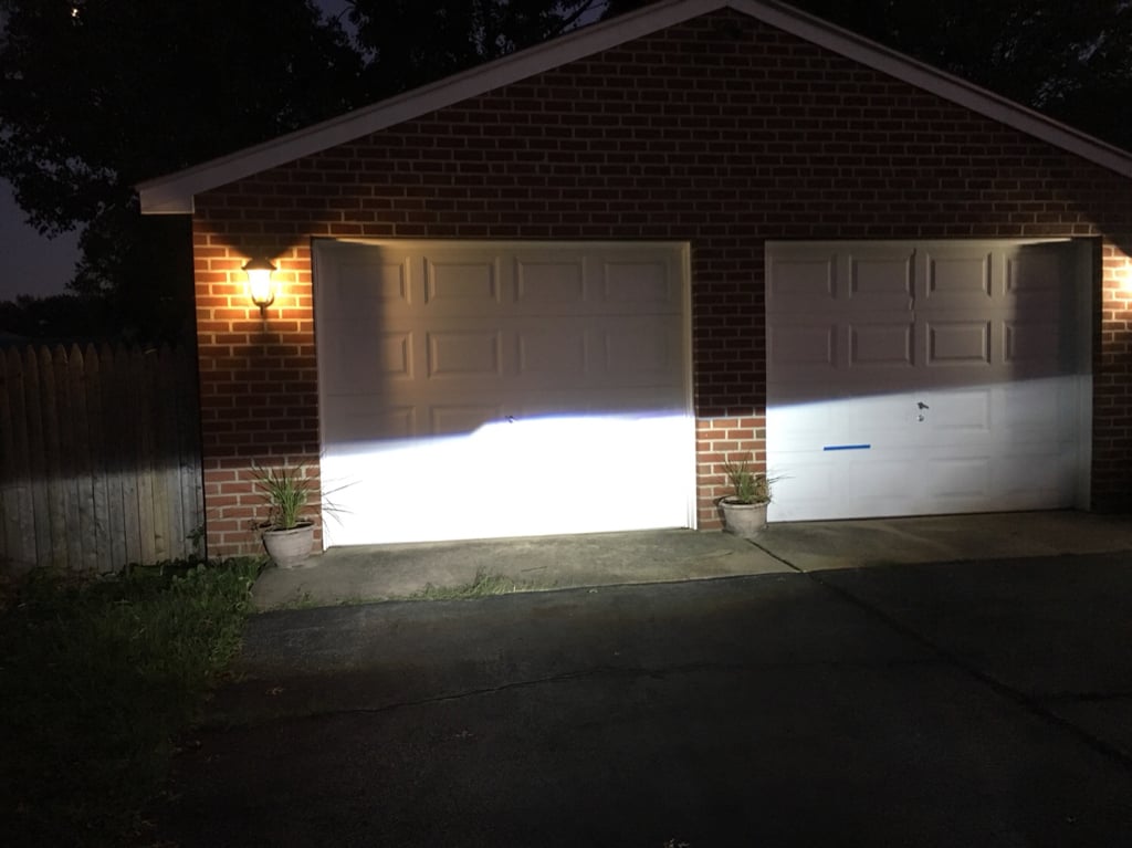

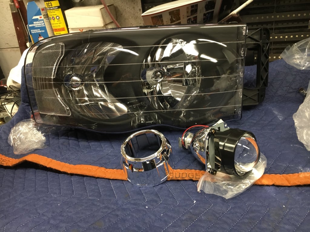

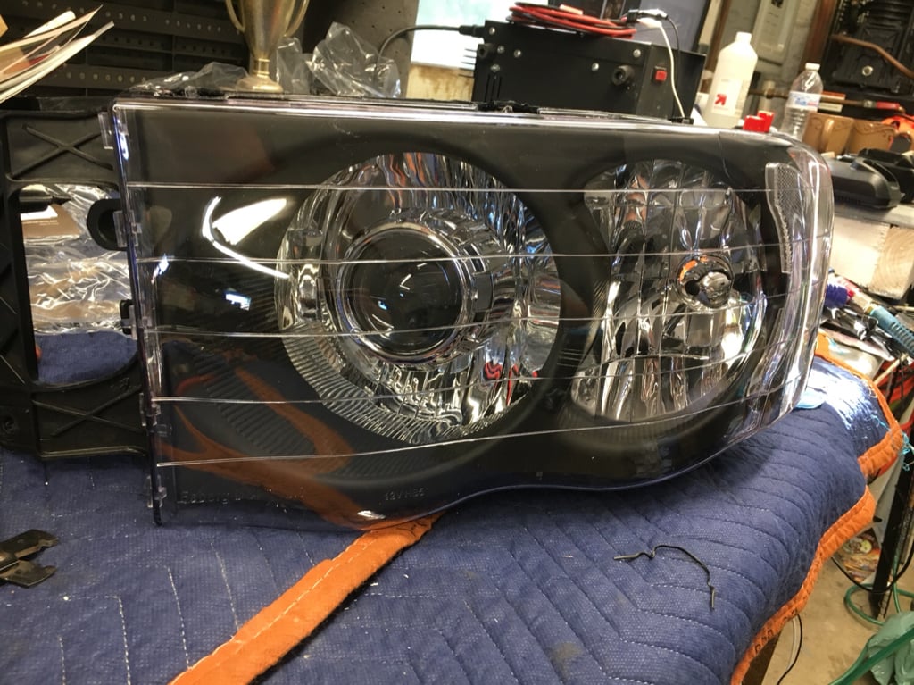

So I built a set of lights. Retrofitting projectors and HIDs into a set of SpecD tuning headlights I bought. Bought all my parts from theretrofitsource. They are badass!! The light output is a tremendous over stock. It was a somewhat tedious project but worth it in the end.
Mounted projector
Test fire alignment and cutoff line.
Reassembled with shrouds.

Now the lens seemed to affect the cutoff after reassembly and blur the line it’s not as crisp. And the damn alignment is off easy to fix though. I’m pretty sure the blurred line is being caused by the bubble in the lens in front of the headlight bowl.
