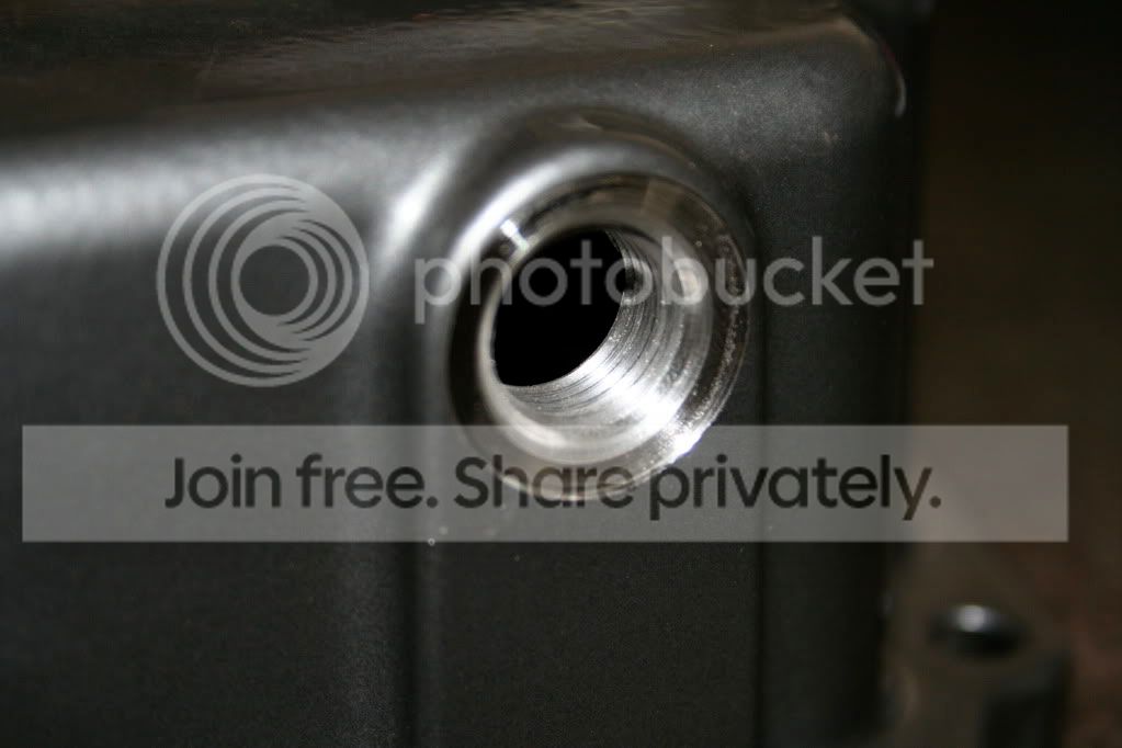

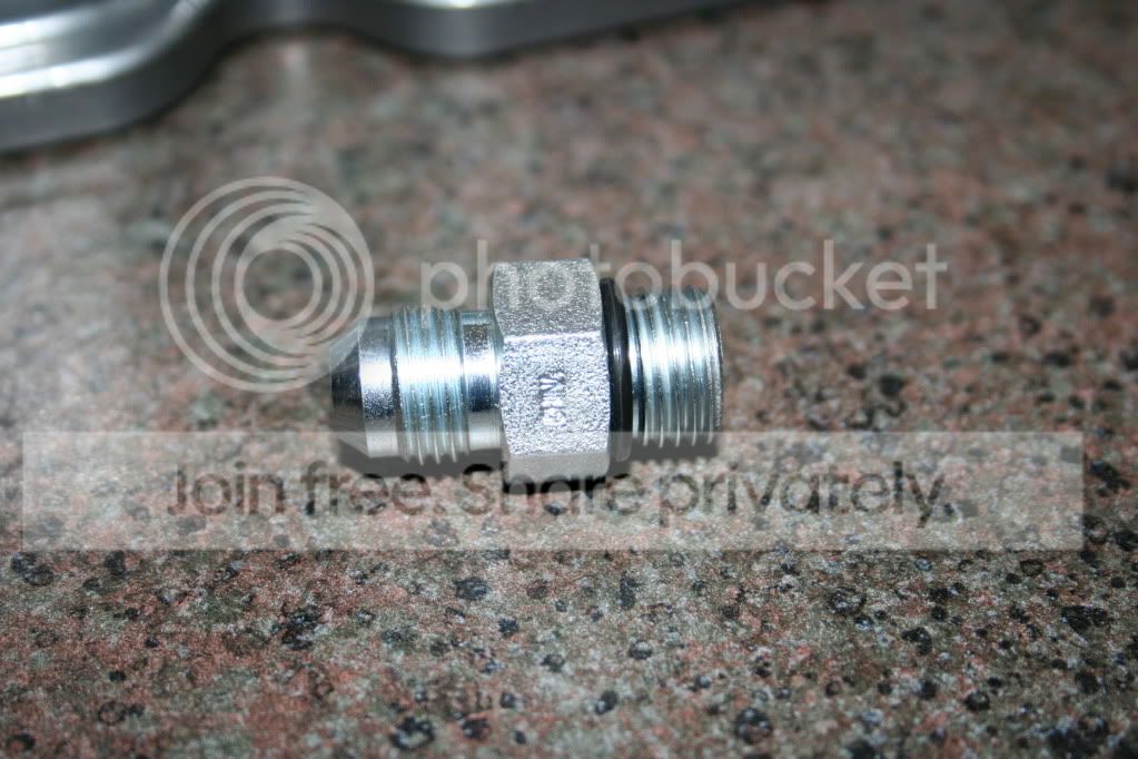

The factory hose nipples are pressed into the covers, so in other words there are no threads. You will have to thread the covers for those. There is a better thread to use, rather than the pipe thread you have shown. It's called ORB, my covers and yellow venoms have been done this way. I started a thread a couple years ago showin what I did, searh it under my name.

Cool, I was planning to thread them if I needed to. :)

Cool, going to use AN-6 as well then. Turned out great btw! :)
I recommend you find a machine shop that is capable of cutting ORB threads, they have a additional boss machined in for the O-ring to seat properly.
You can always use a pipe thread, but personally I hate pipe thread and wish it was never developed.

That is officially an MS16142-6 Port (SAEJ1926). Any decent machine shop with that specific port tool and a 9/16-18 Tap can cut those for you. Never use a pipe thread when you can use an O-ringed fitting.

Great info, I figured there was a ISO term for ORB, but have never been told what it was.

Boss is the way to go I work at a hydraulic shop and everything i deal with is 2500-4000 psi and we use boss to AN- all the time with no problems just dont reuse the orings when you are running 2500psi lol
have a machine shop do the threads and boss cut and you will never have a problem out of it
