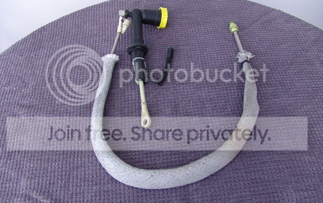

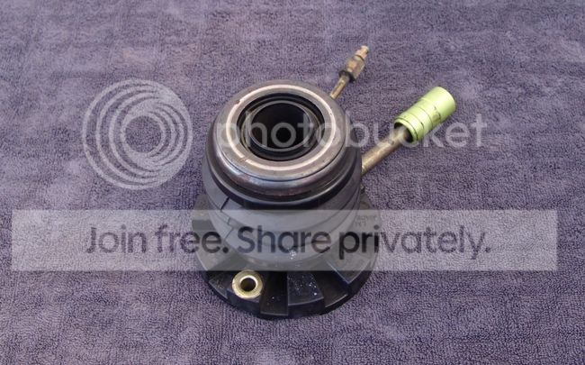

I have a near new (7,000 miles) master slave and clyinder kit in the for sale section for $150 + shipping. Just sayin'! :D
http://www.vtcoa.com/forums/f14/massive-srt-10-parts-clean-out-photos-56535/
