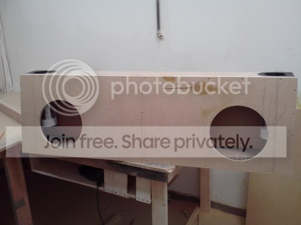

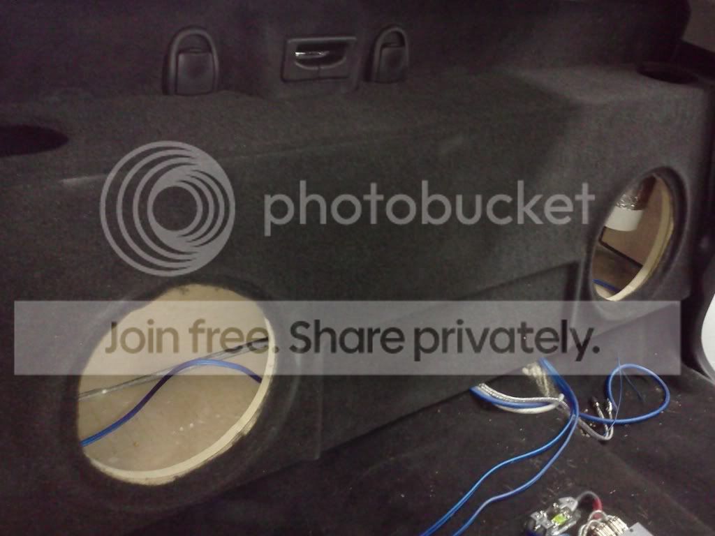

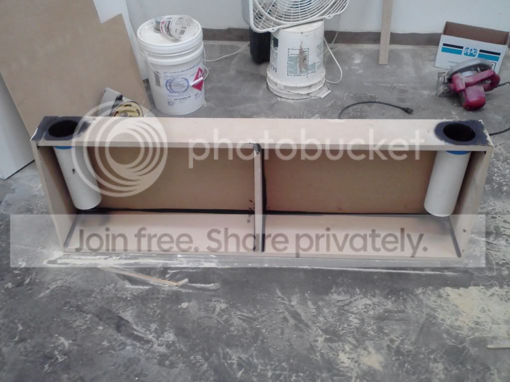

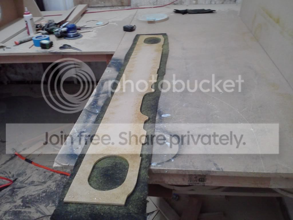

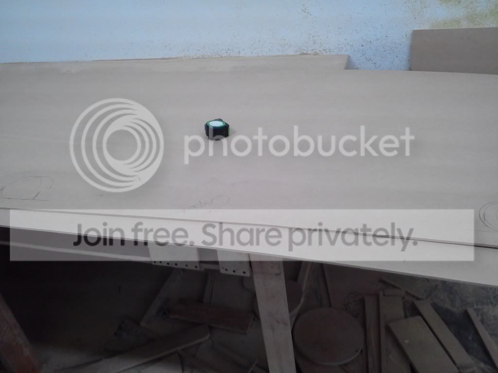

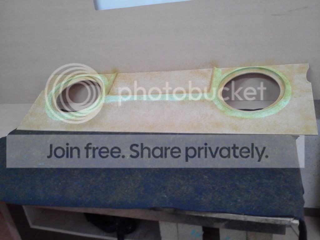

How much port did you use? It doesn't look like a lot of port for the subs. What frequency did you tune them to?
Ended up using round Sonotube ports instead of a slot port due taking up less air space in the enclosure. Ended up being uned @ 32hz, should have it up and running today and tuned.
Awesome. I only had one ported sub (JL 10W7) and never liked it. I always used sealed boxes with my installs. But Adire Audio and ID Max are way different to compare to a JL Audio.Ended up using round Sonotube ports instead of a slot port due taking up less air space in the enclosure. Ended up being uned @ 32hz, should have it up and running today and tuned.
