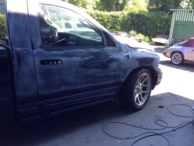

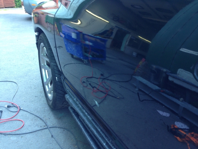

Took some time to clean my 2004 SRT10.
The paint job was not in perfect condition, so i took the time
to wet sand it with a 2000 grid and afterwards did a 2 step
polish job.
Now its shiny again and the long summer cruising nights can come.
Still have to add some parts, that i removed before doing the wet sanding and polishing.

damn!! is that factory paint?? i didn't think you could get the orange peel out of factory paint without cutting all the clear off and then supe fine sanding then respiring clear again
Ya. Factory. All I did was clay, use a fine rubbing compound, Polish, and then wax. All Adams polishes.
Only did the door. It took 1.5 to do that much!
