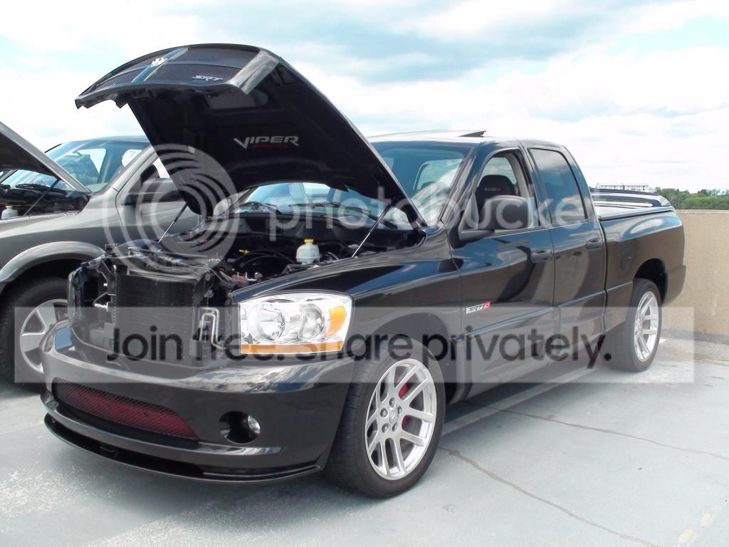

Definitely lowered, here is a pic of mine...I can fit my head in above the back tire! :D
Ok, so i guess im lowered. I love the look and stance. Looks mean, now, how do i tell if it was done properly? What do i look for. I know in the old days they used blocks, but i see leveling kits and such now.
Very lowered! Your truck is very lowered! Oil pressure is normal. What you are experiencing on the highway is called "bump steer". It is a common thing on these trucks. The only known fix are tie-rod flip kits. www.jtsvp.com sells them. I have a set but have yet to install them. So I cant say for myself that they correct the problem. Others have installed them and it has seemed to work.

Hey, I didn't say it would fit snug!:D
Dont mean to change the subject but by the look of your pic are those the air deflectors behind the grille ? if so can you tell me if they are attached to the grille ? i have mine that were given to me loose but couldnt see how they attached to the radiator support
Yes, they are attached to the grill support or hood somehow, I can take pictures possibly tomorrow if you would like, unless someone else beats me to it!
