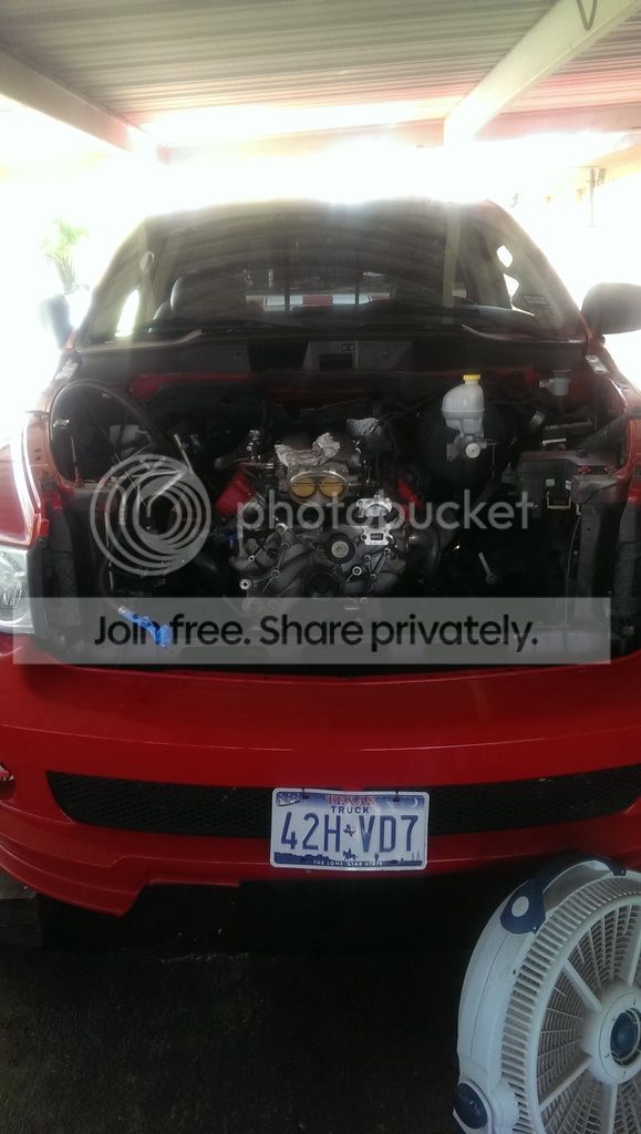

Sounds great Scott! Hell, maybe I need to talk myself into some head work too lol
