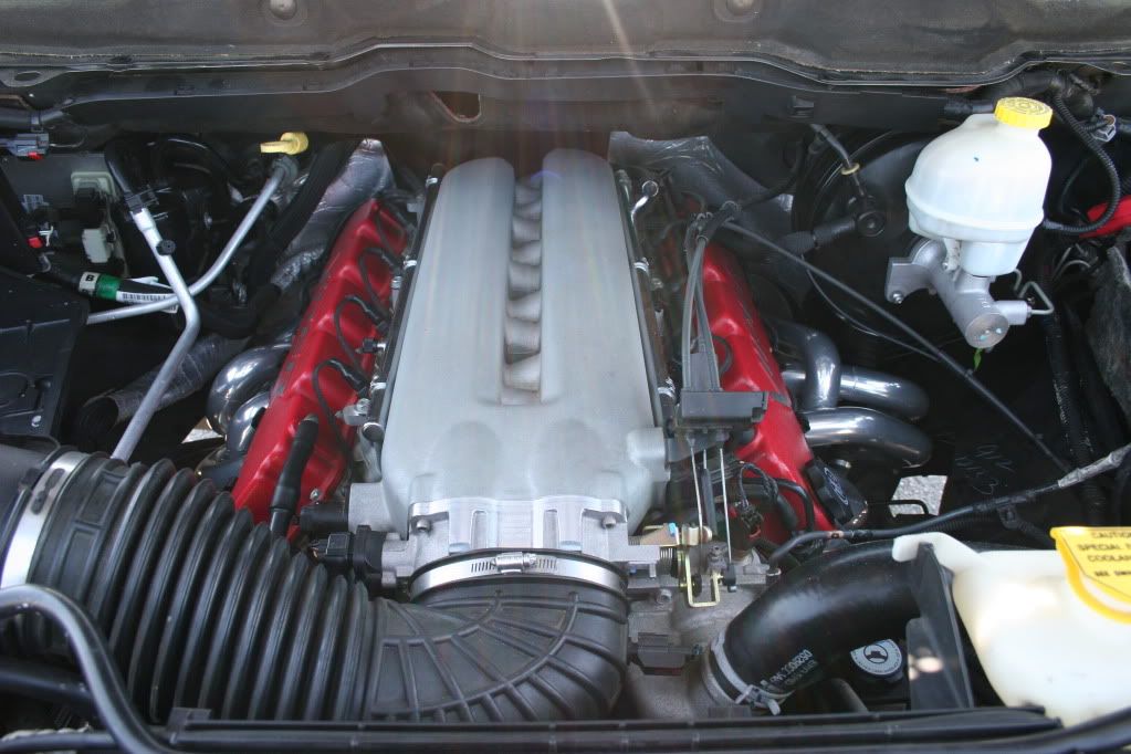

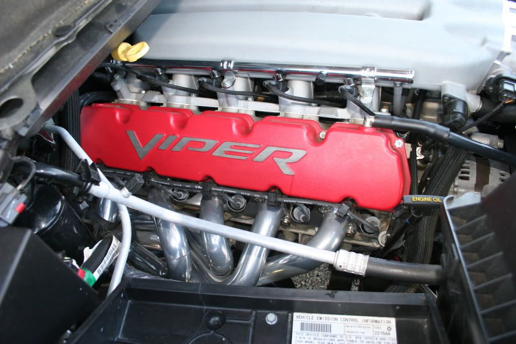

I got my Headers from Donnie (AlexsPop). They were already Jet Hot Coated
Inside and Out (Thanks Again Donnie
The Mopar Headers and Mids come with 4 O2 Sensor Bungs already installed.
All 4 of the Bungs are located right at the Collector. 1 each on the Headers and
1 each on the Mid Pipes.
Donnie had already thought ahead about a Wide Band Sensor and had and Extra
O2 Sensor Bung welded into the Driver's Side Mid Pipe located approx 3" from the
existing Bung. You may also wish to have an extra Bung put in for a future Wide Band.
You could also go really wild and have a Wide Band on each side.

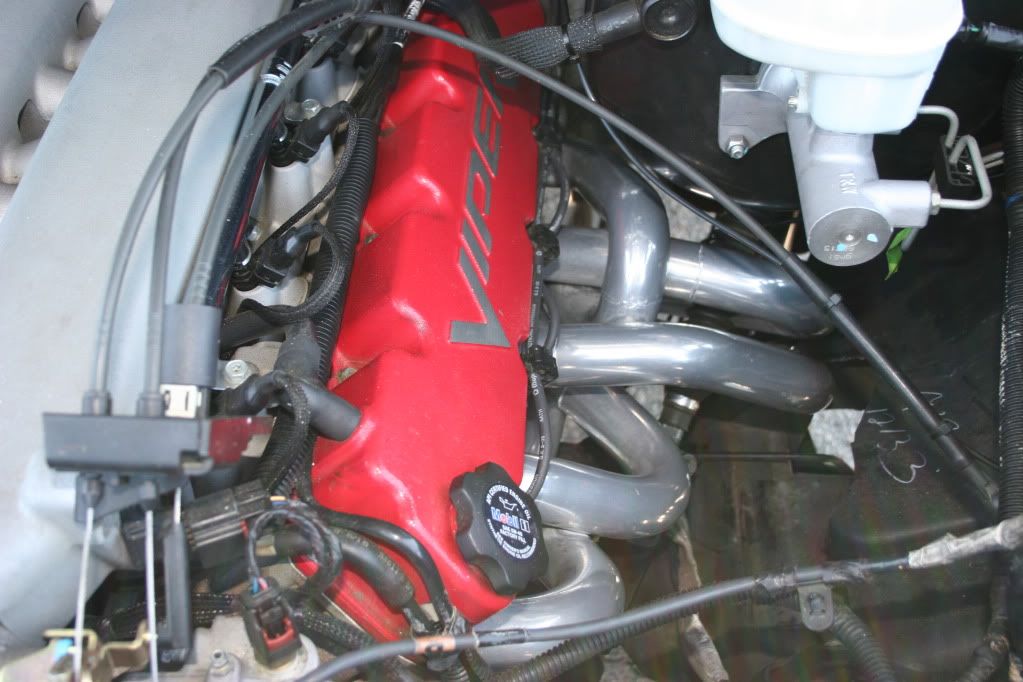

Zip Ties to make sure the O2 sensor wires don't get anywhere near the heat
If the Headers are NOT Coated then you will need Heat Wrap. You basically
wrap them up like a Mummy from the Exhaust ports all the way to the Collector.
It is cheap so I got some to take care of things that are close to the Headers
(Wires, Cables, Hoses, etc....)
***** Warning***** If your Headers are Coated DO NOT HEAT WRAP THEM.
If you do it will Bake the Coating Off the Headers and you will have wasted all
the Time, Effort and Money it cost to get them Coated.
You may also want to wrap the Catalytic Converters to reduce any heat transfer
through the Floor of the Truck.
You will also want to "Trim" the Plastic Inside Fender Well just a little.
The Headers will either actually touch it or be so close that it will melt the Plastic.
Do a Dry Fit and Trim it ahead of time to prevent a "Stinky" Mess.
The above are the steps that I took in the Installation of my Mopar Headers and
Mid Pipes. After 250 miles they are working great, provide a Great Sound,
generate More Power, and the Best Part is there are NO Error Codes....
