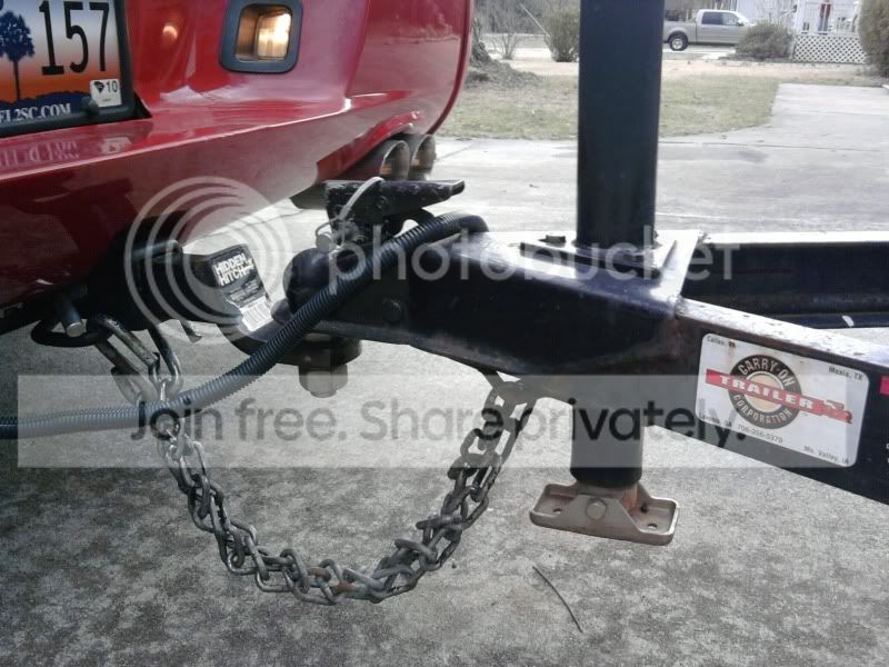

Ok, installed, super easy once you know how to take the side pieces off first. Only a slight bump in the center where the center bolt is now underneath.
That bump shouldnt' be there. :dontknow:
The bolt that goes into that center hole in the bumper support sticks up about 1/4"-3/8", so I am not surprised it has a bit of a bump. I'm guessing that those who have other hitches that are one piece, they have no bolt in that center hole (where you can install a ball mount). Not bad enough for it to bother me.
As you can see, took the notch out so it sits properly at the bottom where it meets the new part of the hitch.
