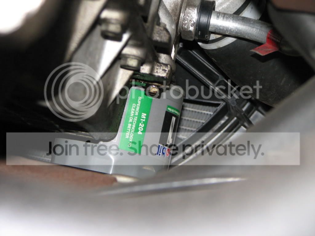

Dealer???, where can I get it today, right now it has a Mobil filter on it...pics in a sec

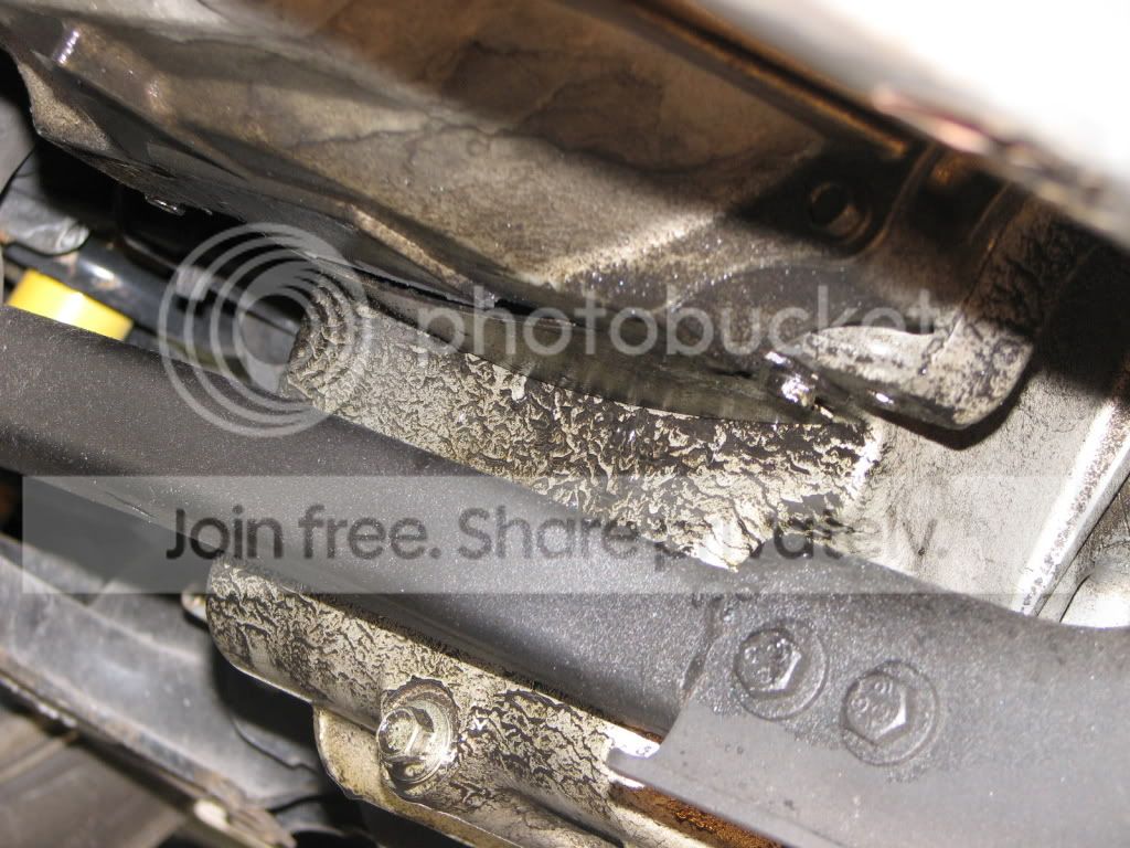

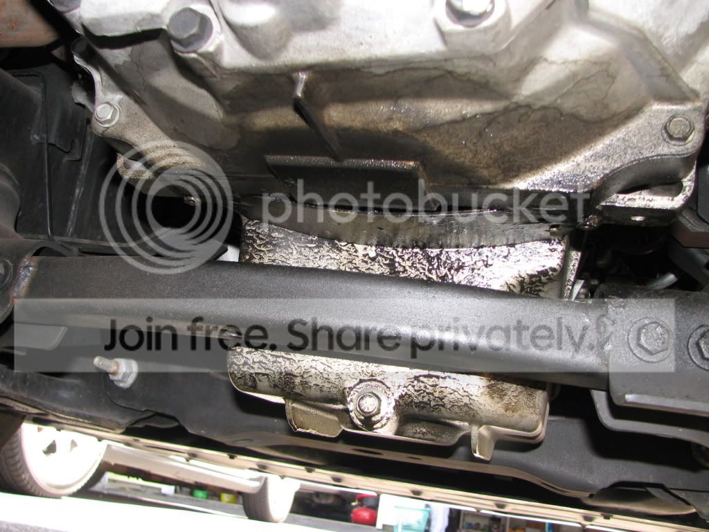

So where is the drain plug in relation to the filter, I assume just in front of the tranny more towards the middle...right where my fat ass cant get to

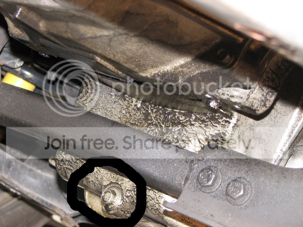

that hickey in the middle of your pic:D
hey if you are under warranty , your rear main is leaking:p
the oil filter is in the front of the engine.
they can be a bitch to get off too bro:argh: especially if the last place tightened it up too much

If I dont have a puddle how big a deal is it to have that rear main leak? I thought it was quite common. AND WHERE THE HELL IS THE OIL PAN, I cant see it
in your post with the pics, the pic to the far left is from the rear of the engine I would suppose the drivers side.
the bar going accross just in front of you is the front crossmember.
directly in front of that with all the oil residue on it , is the oil pan.
the bolt in the middle there, near the bottom of the pan, is the drain plug my good man:)

If I am hearing you correctly the last pic is almost a zoomed in pic of the plug??? I thought that was the tranny
I dont want to drain the wrong thing. I thought the drain plug was brass colored, shit I hate this
If that bolt (plug) is the one I need I can get to that then I just need to figure how to get to the filter which may be just a turn of the wheel

yessir that bolt in the middle of the first and last pic is the oil pan drain plug, and no sir it want be brass.but that is the drain plug in the middle there in the first and the last pic.
lookin at the first and last pic, if you look just above your hand while under the truck thats the tranny, it bolts to the rear of thengine there,
right where the oil residue is, you'll see a small plate, from there up and back is the tranny, the large part hanging down from the engine is the oil pan.
study it a bit while under there and look from the top also, the engine block goes back to jsut about the firewall , then from there back is the tranny.
be sure to get a good oil filter wrench, I like the cloth ones that have what looks like a seat belt, not sure if wally world has them or not tho
but they use a ratchet on the bottom and grab the filter real well
OK
I thinks I can do this. Filter is going to be a bitch. What about that filter as I need one today...I want a good filter but I am not going to get a Viper filter at Wally world. Is that mobil filter good and where the hell would I get that. I promise I will be busy a while after this and leave yall alone
I have allways used the mopar filter from wally world, but mobil 1 filter is excellent too.
the mobil 1 filter they carry those at wal mart also, or autozone has them not sure about advance.
but ithink autozone has the K@n filter too.
since the dealership is closed today I think you would be fine with any of the above filters.
