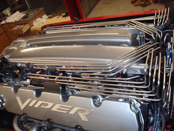

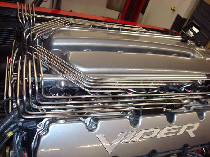

picture of direct port NOS

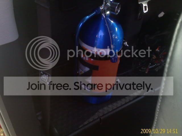

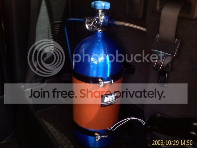

how did you mount your bottle brackets, thru the back of the cab ?:dontknow:

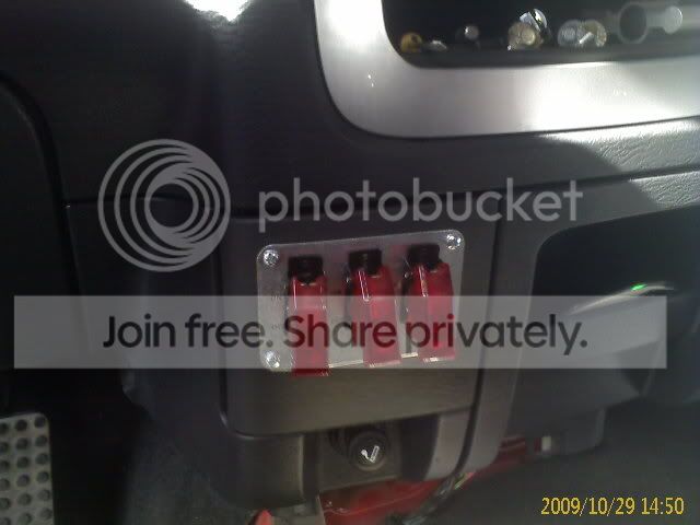

your 3 switches - arm, bottle heater & purge ? :)

thanks. The bottle brackets are steel and i had to cut them and re weld em to get rid of the angle they had for laying the bottle on its side.
the only go thru the plastic storage bin and the rear trim panel..Not thru the sheet metal:eek: This is how justin has his set up as well. The blow down tube goes thru a rubber plug thats in the floor so i didnt have to drill any holes.
The 3 swithes are for ferm, arming, line lock and bottle heater..I have another momentary push button for the purge that isnt mounted yet.
I decided to mount on the ash tray incase when the nx system comes out all i have to do is get a new ashtray door.

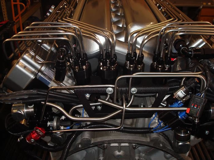

the nozzles will be placed just as justin has em..
My solenois plate is custom made here @home
ferm?? what's that ? :dontknow:
nice solenoid plate......:)
