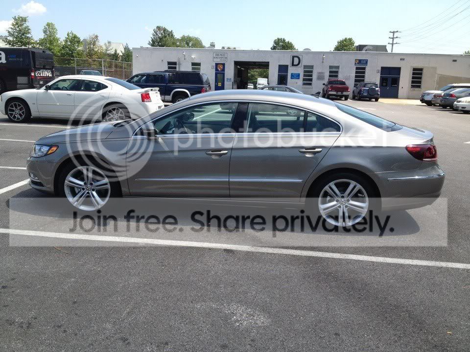

What car did you get RAMDUDE? Your truck was one of my favorites on here, sad that you got rid of it.
2013 VW CC Sport/Plus.
Thanks buddy, Yeah I loved the truck.
