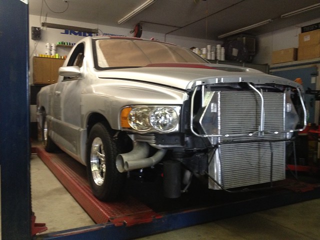

Got the JTSVP extreme lowering kit on it.
With justins bushing handling upgrade and qa1 shocks from JMB performance.
Lowered the truck 8 cm in the from and 13 cm in the back.
That would make a 3/5 " drop. ;)
Really want some calltracks on it, because I believe they would improve the handling even more.
Here some pics of the queen:
