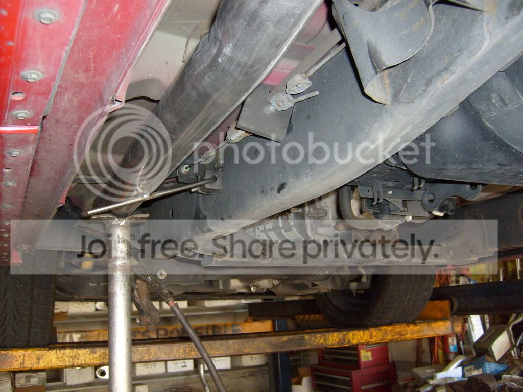

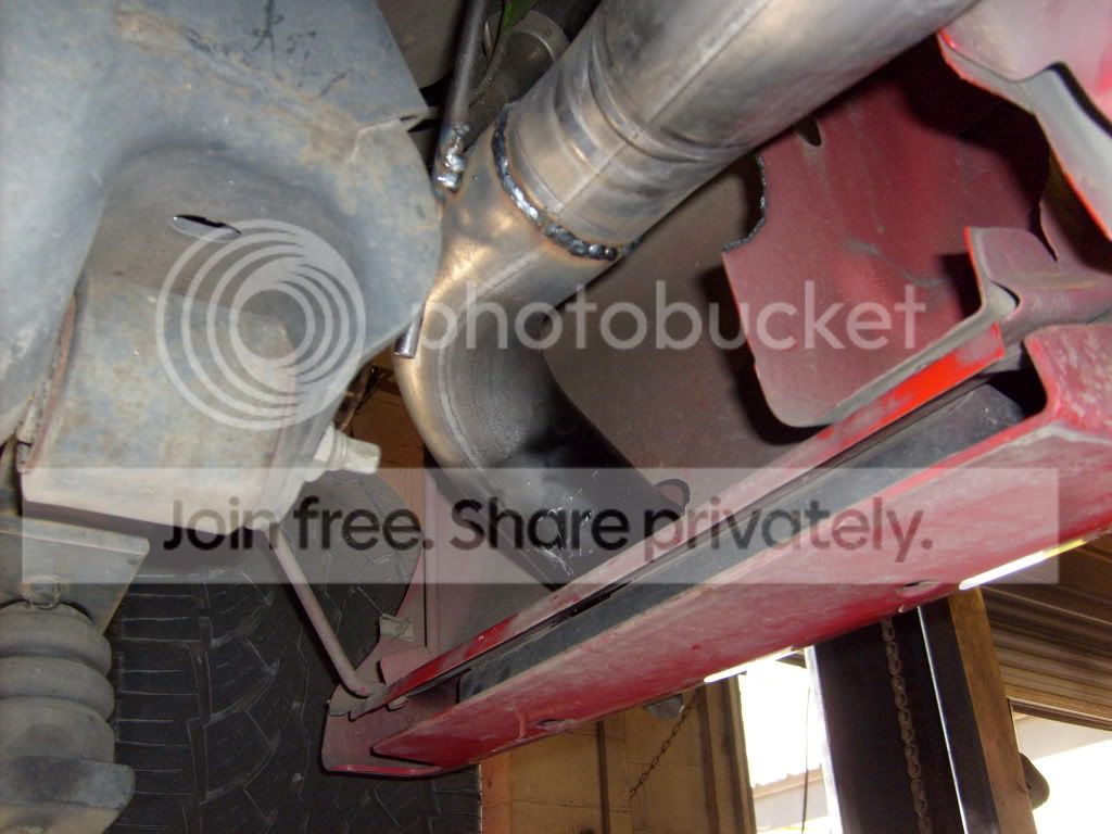

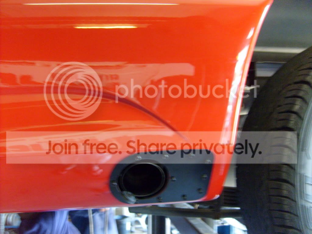

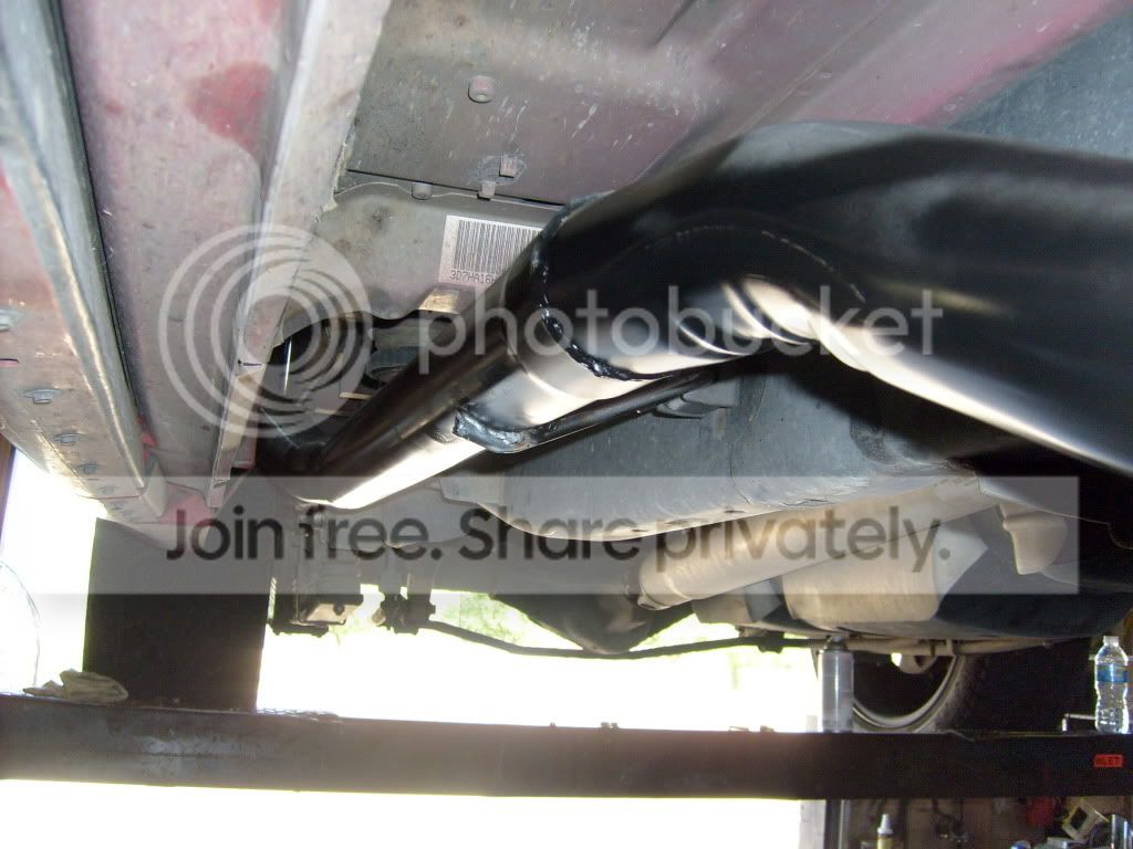

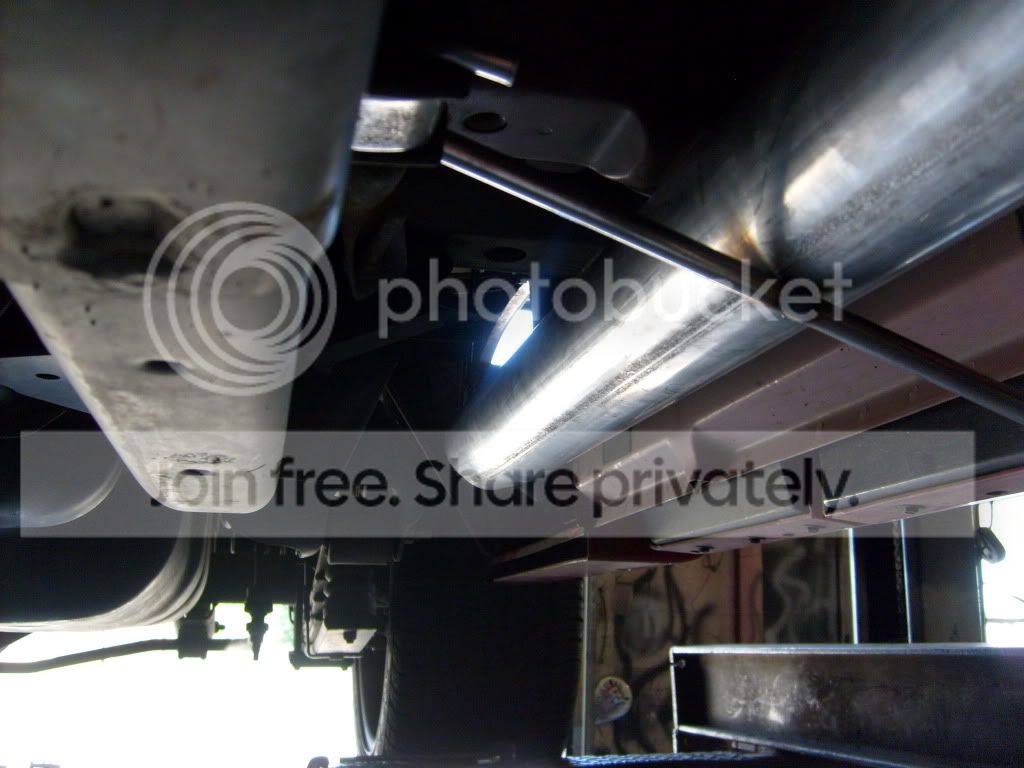

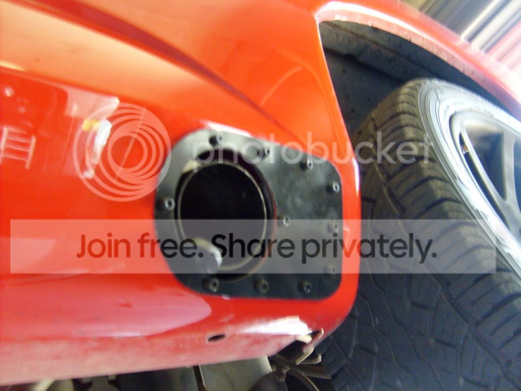

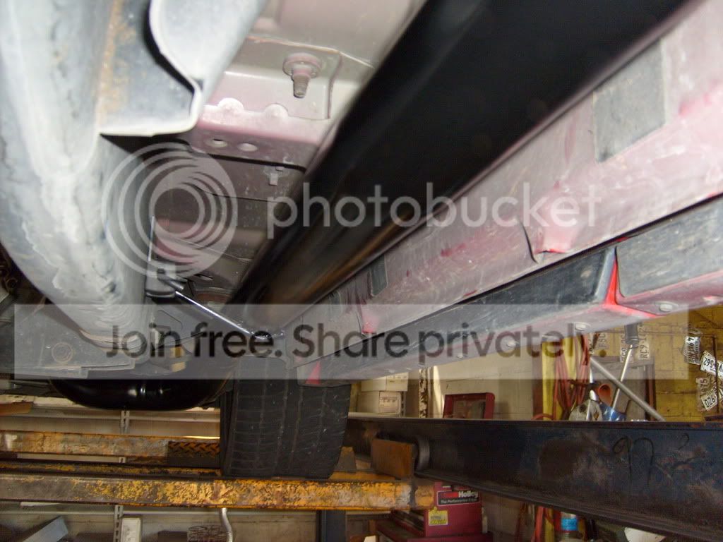

Like the title says.. he droped the truck off with me yesterday and i went to work and heres all the pictures.... so all you guys that want to attempt it your self or cannot bring your truck to me heres the pictures we have all been waiting for..... this system is a Full 3" with a 3 1/2 inch tips The tips are 3" but i flaired them to 3 1/2 for about 3" trying to get a nice tone out of it! will have video up tomorrow on to the pictures!
Bone Stock "Before"
Hole Cut
Plate
And Underthe truck pictures!
Mock Up
Empty Space
Tip With 45º Bend
Down The Frame Rail
Hanger
Better Picture of tip
Coming Off The COllecters
Pipe ran

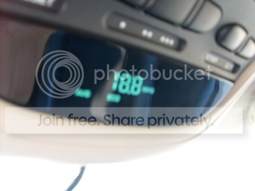

With The Cats Gone This went from 14.1 MPG on The Interstate at 70mph to ...
Hope Yall enjoy i'll have video of it up in the morning!!!!!!:rock: :rock: Tyler i hope you like it man
that is an srt10 ? 18.8 mpg ???? wtf - what am i doign wrong ???
im gettin 8.7 mpg
im gettin 8.7 mpg
yes sire this is Tylers SRT-10 doing 70MPH with no cats

wade your the man and yes im puting mufflers on eventually i just wanna be retarded loud for like a week then ill tone it down alittle:rock: :rock: 18.8!!!!!!! HOLY S#!T!!!!!!!!! well just hit me up when shes good to go with gettin picked up:burnout:

Just a thought, if that plate was made thicker, then the holes for the fasteners were countersunk for flush head screws, that thing would look a lot better. Just 2 cents.
i tried the flush head screws.. an i did not like the look of them i like the mechanical look better... and the plates can be made thicker but i'm trying to keep the plate as thin as i can so it does not stick out of the body line to much
