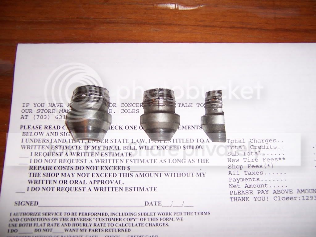

Just wanted to post the result photos and how-to :D
Basically went down to NTB today because the master Mech. would be there
turns out he went home early.. Anyways, long story short they got the cracked
wheel lock off and what they did was they got a bigger socket (24mm) then
hammered it on over the wheel lock. Using an impact wrench they then proceeded
to remove the cracked wheel lock. Now in my special case they had to use
the key to finish the removal but i think in the general case of key loss or something
else this should work :) ... and of course, pictures :rock:

Yeah these were the Mopar locks.. I was trying to find a set of locks that
were discrete in that they looked like another lug nut but really it's just a plastic
cover on the lock itself..
