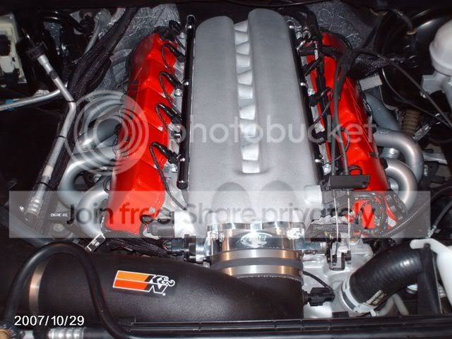

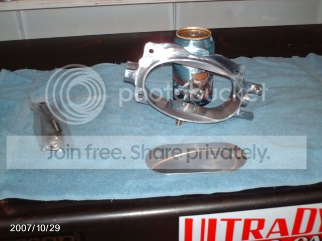

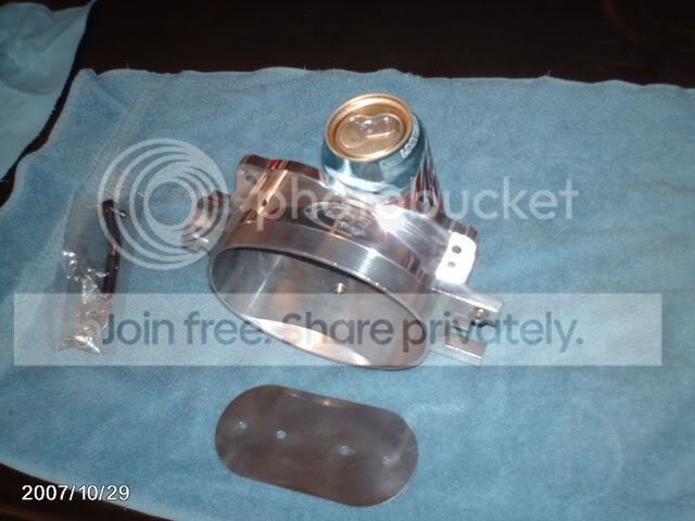

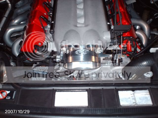

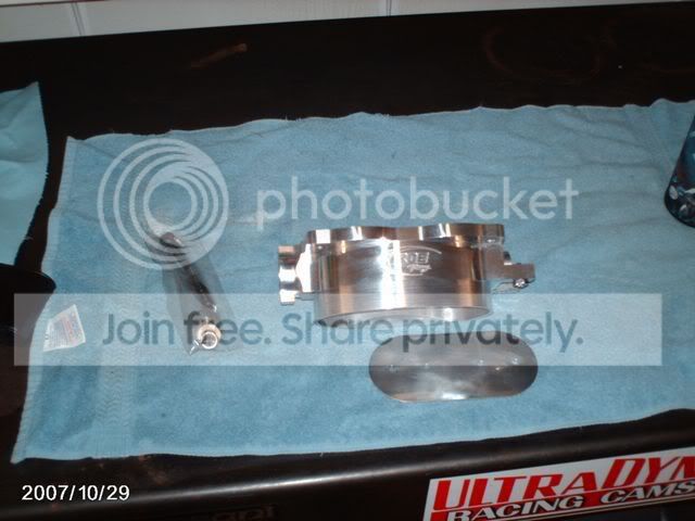

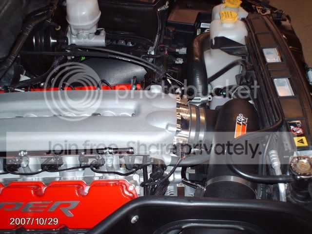

I got my Roe TB today and installed it. One thing I did different from Roe's instructions was I heated the TB in the toaster oven like he recommended, but I also put the bearing in my deep freezer. They had a pretty good view of a couple corn fed ribeyes. After about 30 minutes, those bearings just dropped right in that TB. I took some pics for everyone.
I port the stocker, but here they are together:
-Muzzy
Man, it looks great! You could eat off that engine, so clean...

I just took it for a short drive last night, but is feels like it pulls harder in the mid to upper RPM range. I will be driving it to work today, so I will give a better report later.
I have been debating pulling off the intake and polishing it. I am not sure if I want to invest that much time. It will probably end up doing it some day.
The TB from Roe is a nice piece. Very good quality work. Everything fit together perfect. You don't realize just how cheap the stocker is until you see them together.
