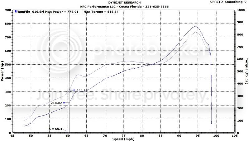

This PCMSCAN is neat it's got a dyno, drag stip along with a the parameter graphs.
