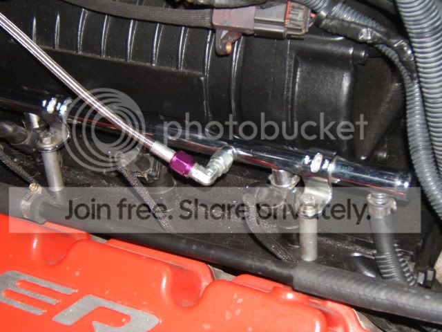

I took a second look at your connection at the fuel line, what kind of hose is that? Tony has a nice adaptor that connects between the fuel line and rail and then has 2 ports to plumb into. One is a 1/8" pipe for a fuel pressure gauge and the second is a -8 ORB thread that you can then get a adaptor to go from -8 ORB to a -4 AN to your NOS solenoid. Maybe a better option than hose with worm clamps?
I was hoping the guys at PCB will take a gander at the set up and spot any issues or improvments that may be possible. If so I will correct them when I get back to Houston.
