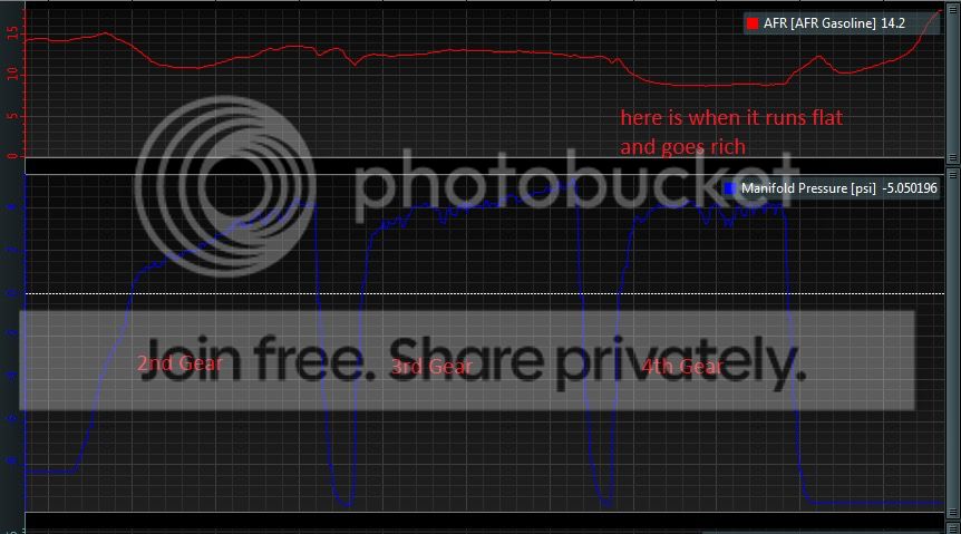

Good evening all,
Having a little trouble with my truck need some help
It's a Paxton truck with a full Torrie sct tune and parts
When I'm at the top end of the rev range (about 4.5-5k) in 4th and 5th gear it will suddenly go very rich and bog down a/f hits about 8.5
It's a lot more obvious in this one where the cursor is
I'm ruling out belt slip because boost is still good.
Any thought?

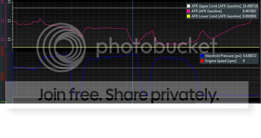

the two things I see are a flat MAP signal and rich 02 readings happening in 4th gear. Fuel tables don't know what gear you are in and I highly doubt that vehicle speed would be an adjustment variable for the fuel tables. It's hard to tell if the flat MAP signal is the root cause or whatever causing the rich condition is affecting the MAP signal. Can you log any other parameters? Logging fuel trims or ignition timing might be a good start. Any other recent mods or changes? Are you getting any codes?
I can only log a/f and boost from the aem gauge.
