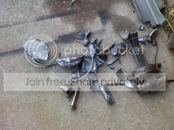

one of the reasons the facotry pistons go boom is if you look at the placement of the rings, they are at the very most upper region, with no support, this is why under detonation the rings lands give way and go booooom

or this maybe?
DAMN!!!! I wonder now what kind of presents I will find in my oil pan.....
Tooloe said:
or this maybe?
Ouch.... you really did go boom... I would frame those, mount them in a block of acrylic, and put in on your desk/whatever... and proudly display your well spent $20k+....

well i talked to david Weaver From A.R.T.. hes been dealing with this for a while he says you mostly do this when you stroke a motor but the machine work to get it to fit a chevy rdo would be $$$ and also it's really not a chevy rods it's still a custom Rod From what i'm told....and yes i blew my motor to pieces..sad thing was i was really doing the speed limit and i'v only sprayed the truck 3 times
So you must've fractured the piston on one of them spray sessions- how big a shot was it?
