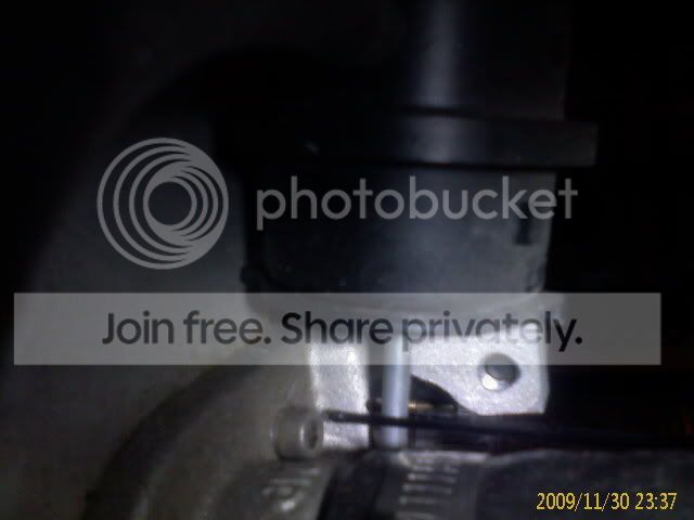

Well since your boost is a lil low maybe the valve isnt closed all the way as someone suggested.
take a look at the rear and check to see that its sitting on the stop..see pic
the pic is taken if you were to be looking at the blower from the driver seat

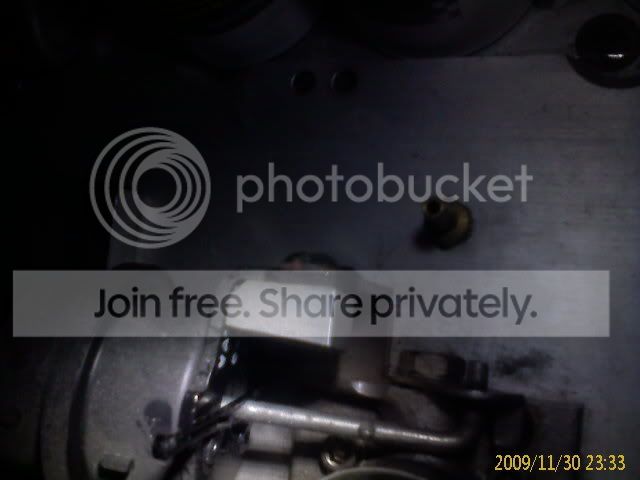

another thing you can check to see if that valve is opening and closing all the way is you place a paperclip or hair clip on the rod of the vacuum actuator. When the valve actuates it will slide the clip(or bonny pin) on the rod and indicate the travel of the actuator. Hopefully it has sufficient travel.
With the motor of or no vacuum on the actuator the valve should be fully closed. see pics
actuator from the top view
here the actuator again with a black bobby pin on the shaft right up against the actuator.
here is me manually actuating the actuator which pushes the rod in and sliding the pin on rod indicating its travel.
overhead pic showing how far it moved
a pic from the side of the blower
you could check this maybe just by driving around
