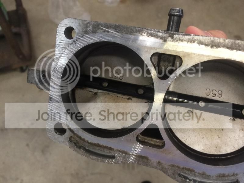

Fucking ruined my OEM throttle blade shaft trying to remove it out of my throttle body for the JTSVP TB.

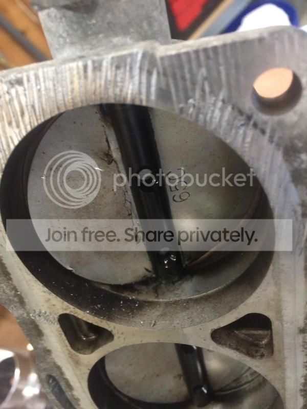

I had the TB in my vice and was tapping the shaft out and somehow the blades got hung up and I didn't realize it.
I might be able to salvage it somehow but i'm checking with Tony first.

Can you post a picture of the damage?
Ok you surely removed screws and removed blades correct? You mentioned they were binding is why I ask? Seems something simple is being overlooked. Pics?

Thing is no tapping is necessary bro! Once blades are removed it usually slides right out. Hopefully shaft is still good
You haven't removed screws or blades? That's your problem boss
Looks like one blade is bent up? You won't reuse them so it doesn't matter, but looks like you were trying to remove blades with screws in tact? Maybe E is right, you need to bring it to a shop bro
