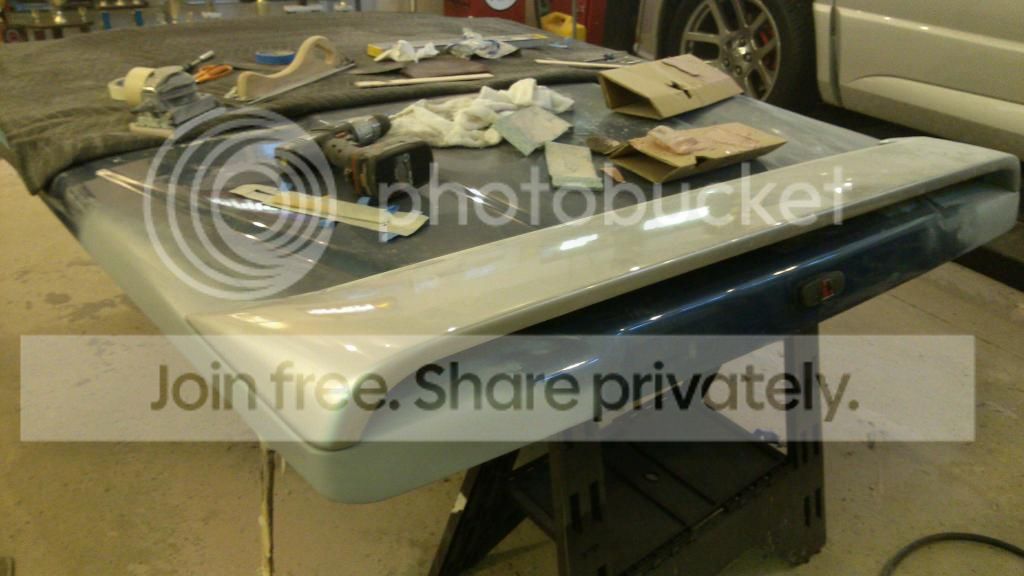

Thought I would share what I did to my '04 RC. I like the stock wing but I also wanted a hard cover, so....
I purchased a Lund cover and modified the top of it to accept my stock wing. The wing is attached with the factory hardware so it can be removed and returned to stock if I ever decide to do so. (doubt if I ever will). The wing is wider than the cover, so the cover had to be widened so that it matched the profile of the bed and still matches the base of the wing.
Here are a couple pictures:
Done:
