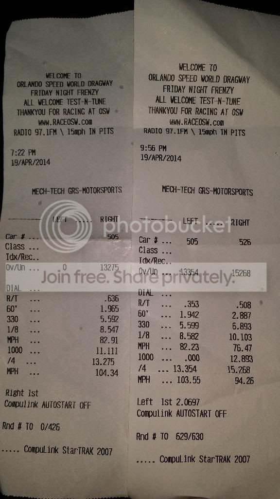

Went to the track last night and ran a best of 13.2@104. Mods are in my signature. Pretty happy to be in the low 13's with an automatic quad. Now to break into the 12's. Best 1/4 on the left. Best R/T and 60' on the right.
So now, I need some suggestions on what to do next to get into the 12's. I plan on getting a TB next, but that won't do .3 seconds off. What else should be done?
I agree on the torque converter, although I don't know much about racing automatics. You could get a set of 17X10 wheels and some M&H 390-40-17 Drag radials. The 29.5" tall drag radials are almost 2" shorter than the stock tires, helping lower your gear ratio for quicker acceleration. A.1 (1 tenth) improvement in your 60' time will translate to almost .2 in your 1/4 mile time. The torque converter will allow you to leave at a higher rpm and the drag radials will allow you to leave harder. Those two items and you're in the 12's easy.
