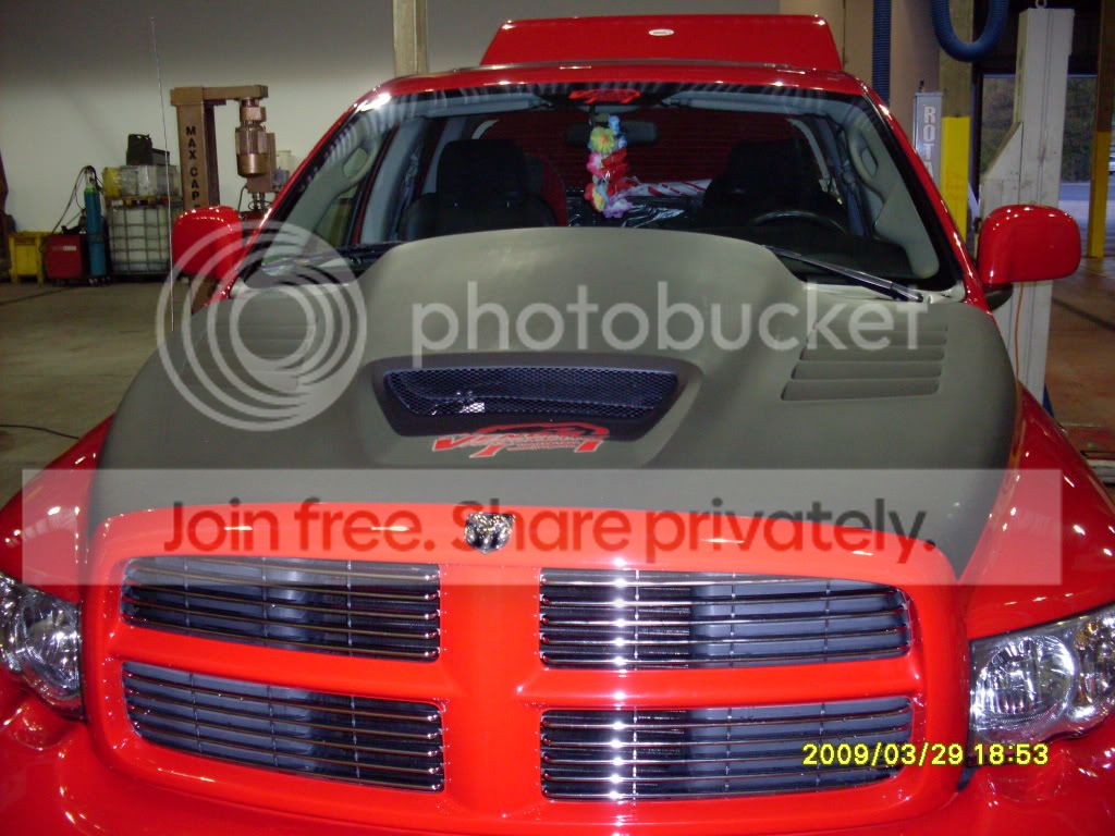

Love the hood! I wouldnt' even paint it. Leave it. Decal and all! Awesome HP numbers!

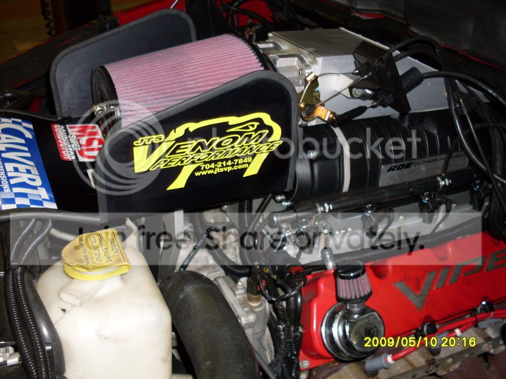

Yeah,but had some problems,fuel pump was losing presure at 5K rpm(from 60PSI to 40psi),super fat tune and now I have plug wires pulling apart:( (causing misfiring:mad: )

What size injectors you running??..
The ones that came with the ROE,49LBS :dontknow:
You need a complete fuel system to overcome your fuel problem...looking at $2K+...........but you can do a fix that will work....60LB injectors and a Kenne Bell boost a pump....around $800....will work but is at the edge..
