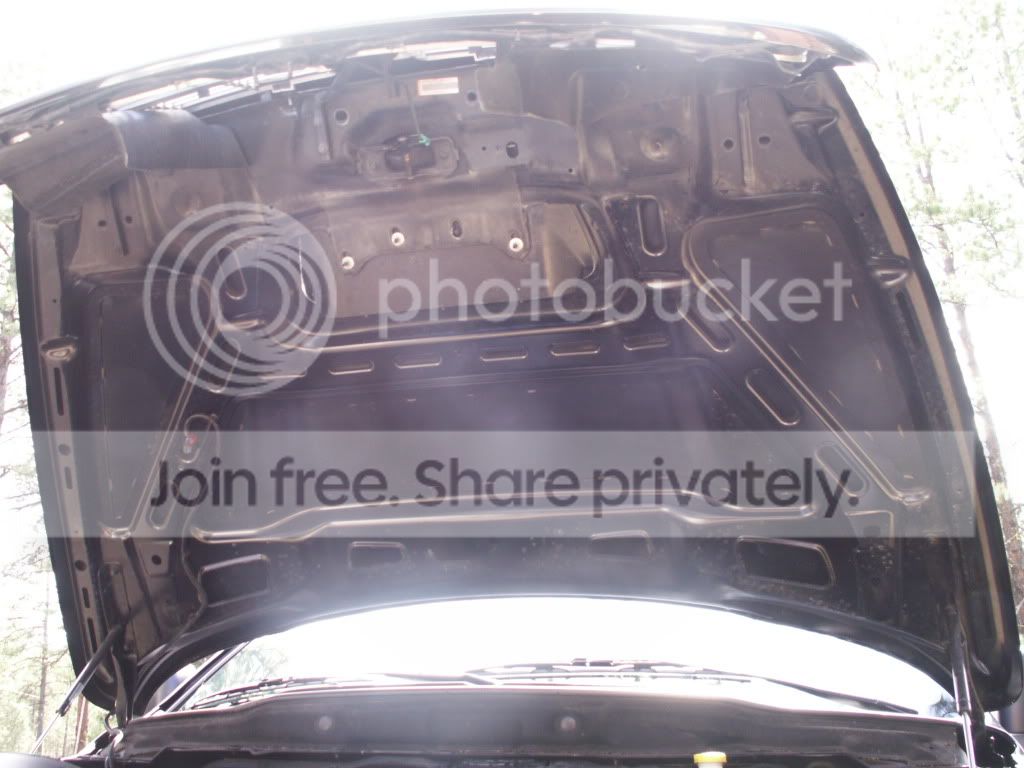

Somebody asked for a picture of the hood without the liner....maybe this will help but it sux cause the sun was right behind the truck.

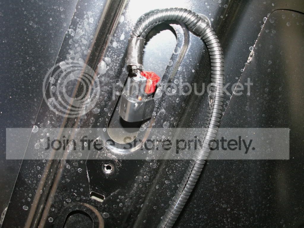

This is where the underhood light attaches to the hood, one sheet metal bolt and a wire clip
The whole box snaps open left to right and the bolt holds it to the hood with the flap

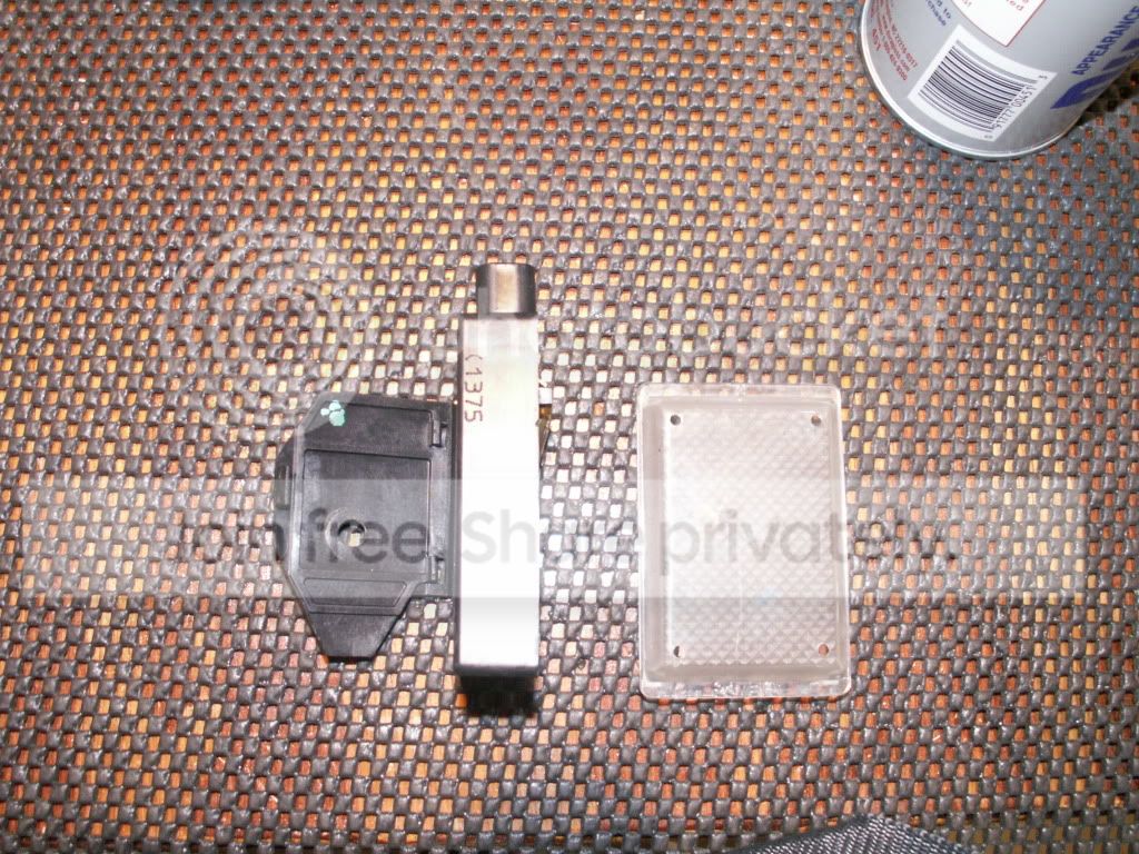

The cover of the light just snaps off using a small flat screwdriver

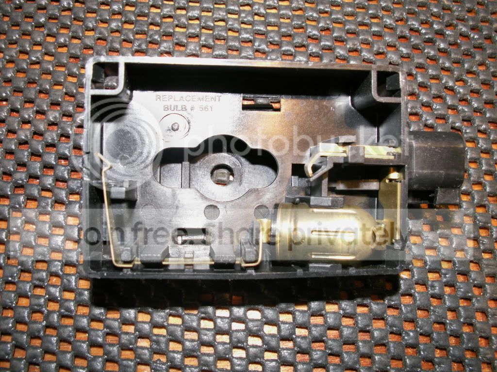

This is the light holder and cover

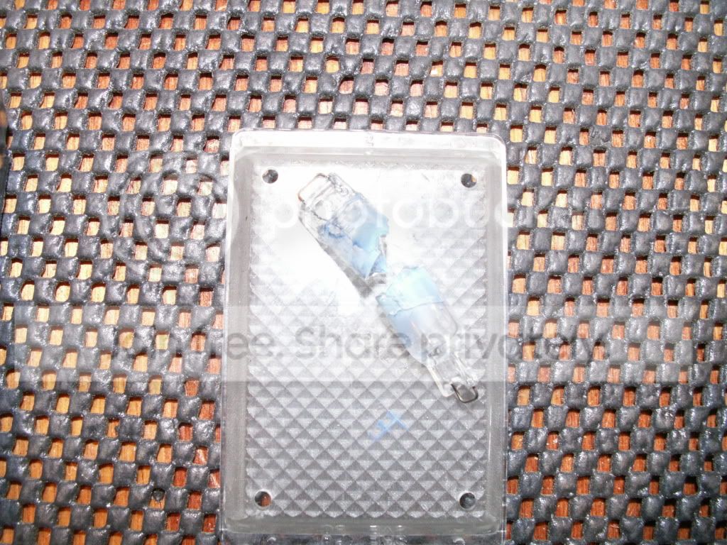

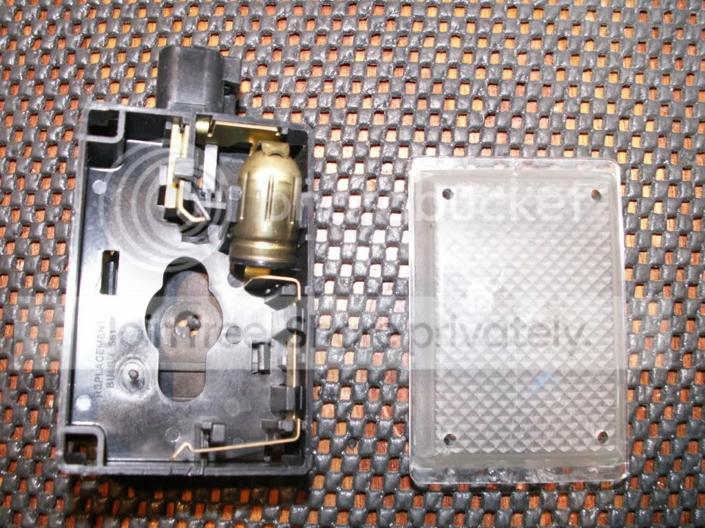

And my broken bulb which hangs between the brass contacts in the next pic
