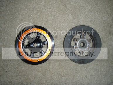

so i used emory cloth and cleaned the crank up. took multiple measurements and all were within factory tolerances!!! i ordered a new balancer from dc performance. its SFI approved to 9000 rpms and very nice quality.
installation was a pain a$$. no auto parts stores carry a specific harmonic balancer install kit for our engines. what i did discover was one parts of an install kit works, the bearing+crank bolt= install kit:rock:

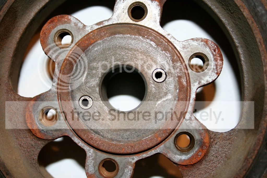

No pictures of the crank as mine is at the machine shop but here is the pinned balancer. When you drill for the pins the balancer is mounted on the crank and you use a special guide tool that ROE has developed. You mount this tool using 2 of the pulley bolts and then use 2 predrilled holes in the guide as a reference. Its pretty simple to do. When you drill the balancer/crank it drills half of the hole in the balancer and the other half in the crank, kinda like how a keyway works. Then when at the proper depth you pound in the spirol pins.
