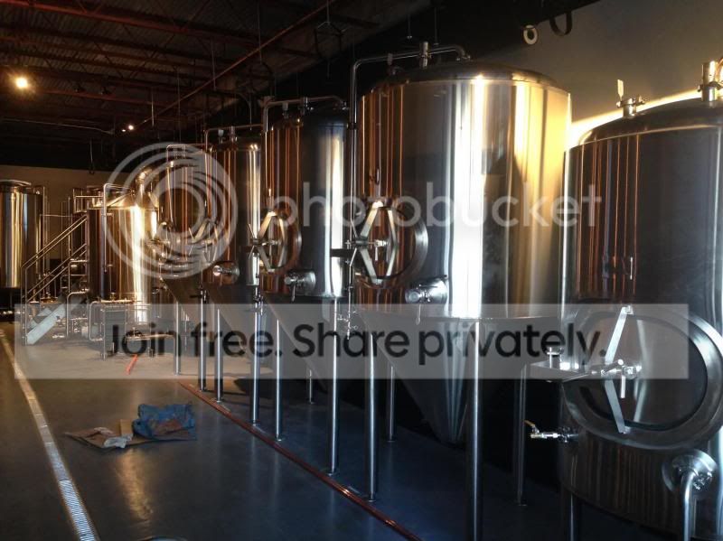

I was wondering what you were up to since the text thread was dead all weekend. :D Pics of the brew tanks would be awesome too.
