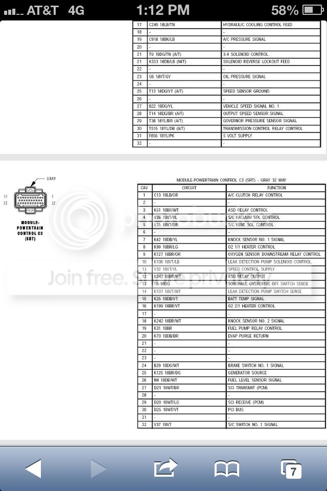

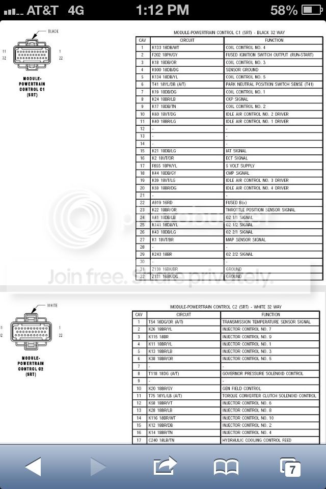

I have a harness I'll look and see what wires. Have never installed one on our trucks. Imagine it needs to be connected to your leads to coil packs though.

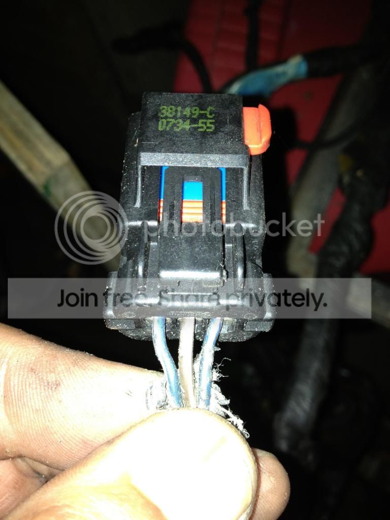

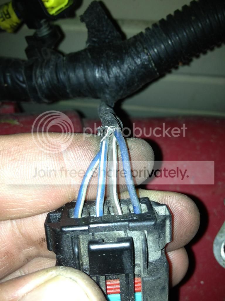

Here are the coil pack connector wires and I assume you'll need to go directly here to bypass our ASD relay.
Colors look like Bl/Or, Br/Wt, Bl/Pk on one plug
and Bl/Yw, Bl/Wt, Br/Wt, and Blue on the four wire connector. Not sure as to what wires are power in/out though.
