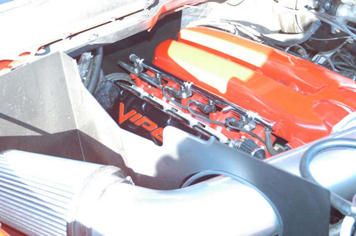

So it looks like a big fake blower when the hood is up? Do you have some detailed pictures of the current set-up. I have only seen one other SRT-10 in the past 1.5 years. And that was driving down the road. If you had some detailed pictures that would be great. Do the other kits have a nice fit everywhere else? IE a good seal on the hood?

Thanks for the pictures, I like the way that mounts. It would look far better in red carbon fiber IMHO. :)
