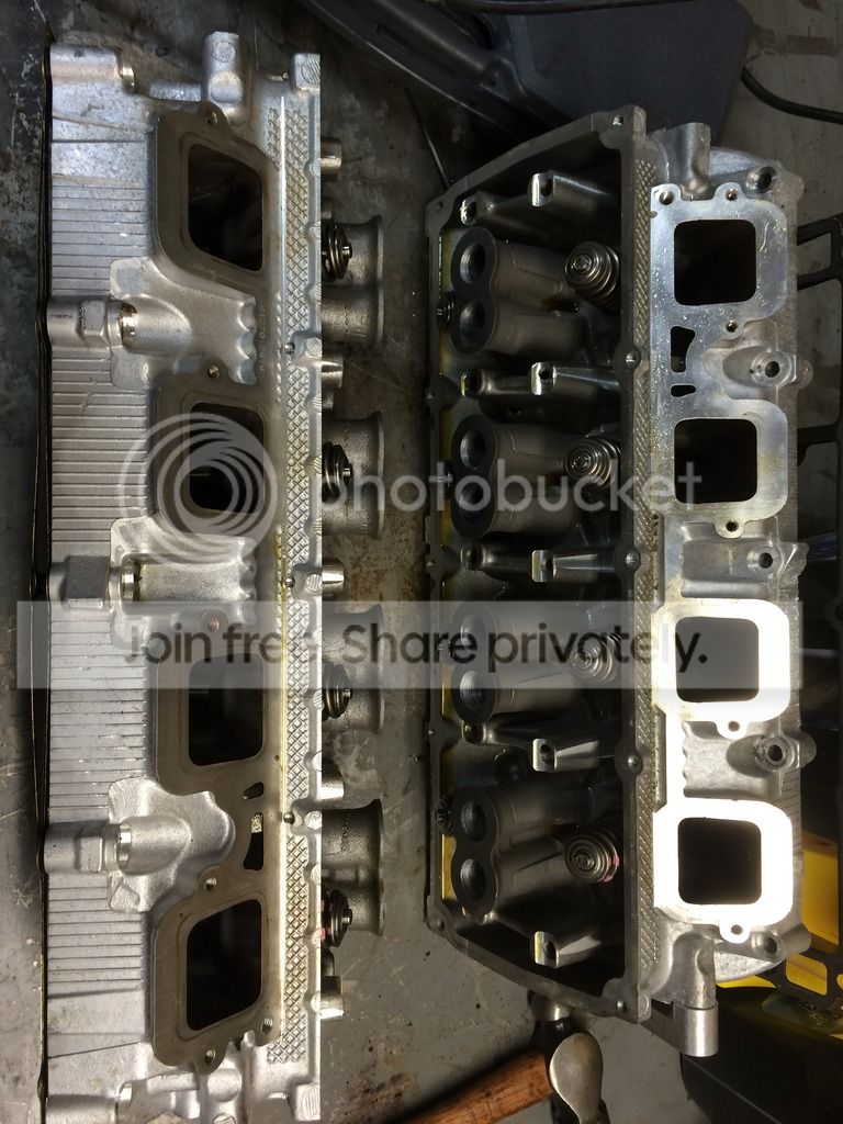

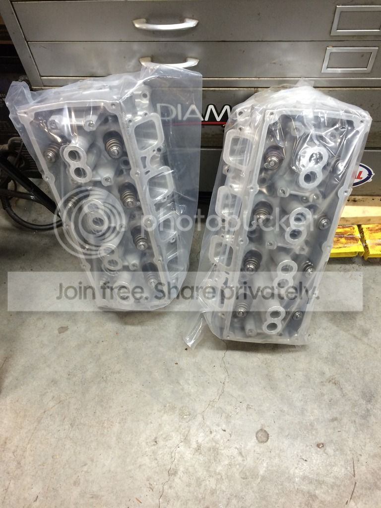

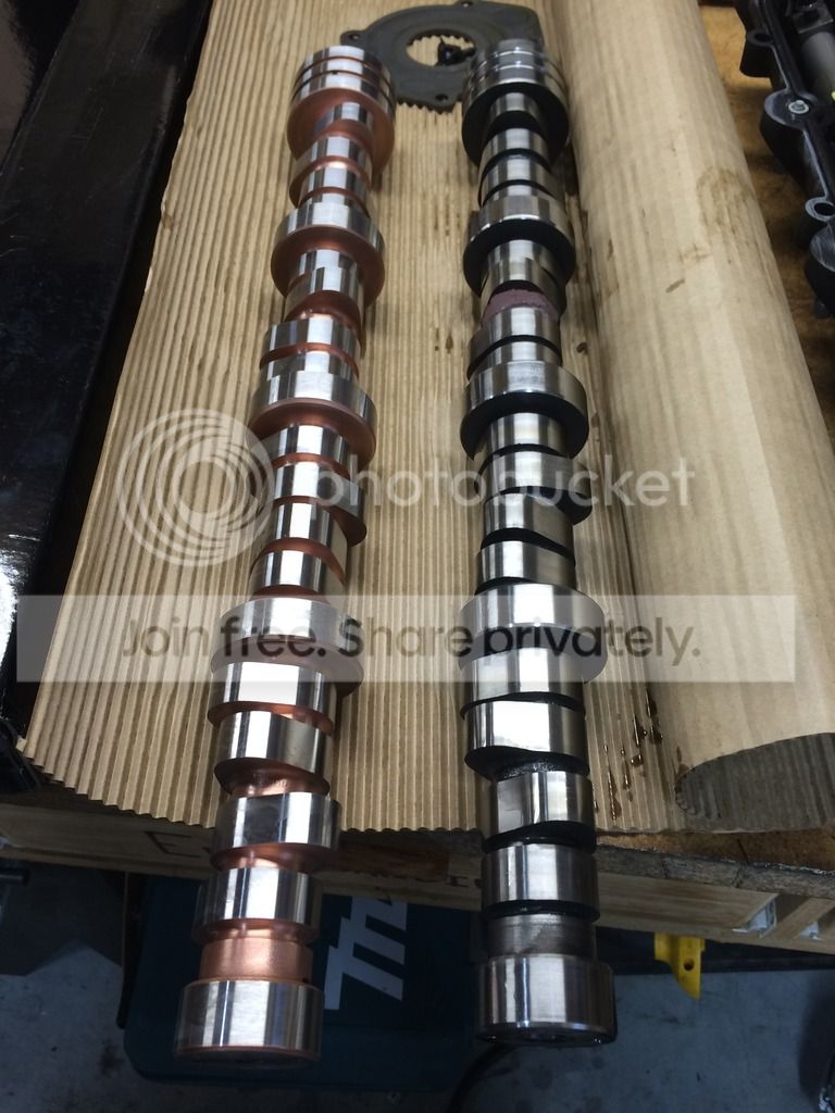

I thought this build would be done at the Procharger, but it wasn't. Just finished installing Inertia Motorsports ported heads and a custom grind cam.
stock heads removed:
Ported heads
Stock cam next to the custom cam:
