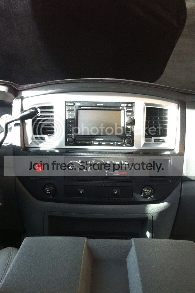

Not part of the conversion but definitely part of the build. Robert (Badplum) has added himself to the list of my heroes by providing me with this gorgeous 06 navigation bezel. Thanks again Rob! :)
Truck looks great lowered Steve, man...my list keeps growing and growing...
Well thanks to Robert and E, I am now a proud navigation system owner. :)
