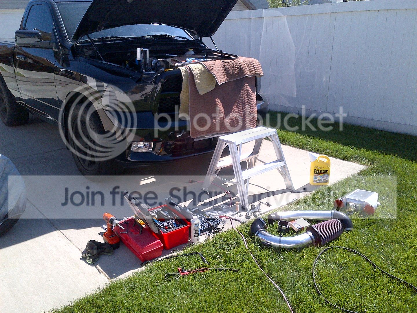

Tuning up my latest toy on the little Black Hemi...
9 psi Boost! Ripp Vortech V3 Centrifugal Supercharger kit
...100% Driveway install on my own with just basic hand tools. 500whp for just $4K, includes tuning
Should have it fully dialed in and my water/meth kit installed soon, along with a custom "Built" transmission.
My torque converter stalls at about 3300 rpm now, so I have to use AWD (4-auto) because 2WD just sits and smokes the tires
Chirps into 2nd in 4WD LOL!
Stock shifts points still (5600rpm) cuz the stock fuel pump cant keep up and leans out after that
Aeromotive Stealth 340 pump is going in to cure that issue real soon.

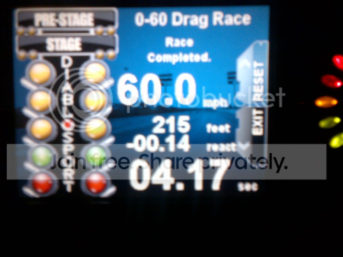

I only got a couple shake down runs in before the track closed. (and my trans took a dump)
My tune was in desperate need of adjustment, running too rich with the W/M injection... low 10's A/F ratio
My stock trans was also failing (skipping and studdering on every shift)
Threw the dreaded 4th and 5th OD incorrect ratio codes a couple days later. :burnout:
...But I did squeak out a pretty good time considering the less than ideal conditions
