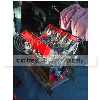

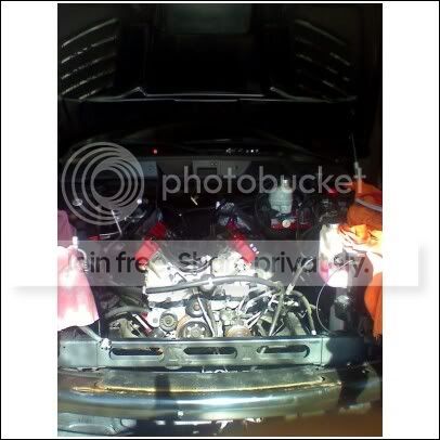

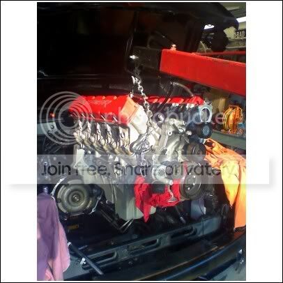

Here are a few pics from today's progress. I'm psyched!!!!!!!!

Fully forged, race heads, custom cam, intercooled and as much boost as the Lysholm will make.
