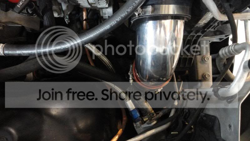

Build an intake like my truck.
Curves straight down and the filter is inside the front bumper in the path of direct airflow.
None of the intakes available are a CAI. They are just intakes. Mine is a CAI. Cold Air Intake. It does not pull air from the engine bay and there aren't any "accordion" sections either.
very nice setup ! ! !
and sounds/looks much better than CAI that sucks hot air from engine...:rock:
