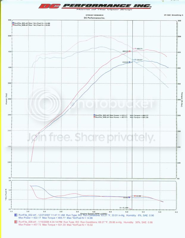

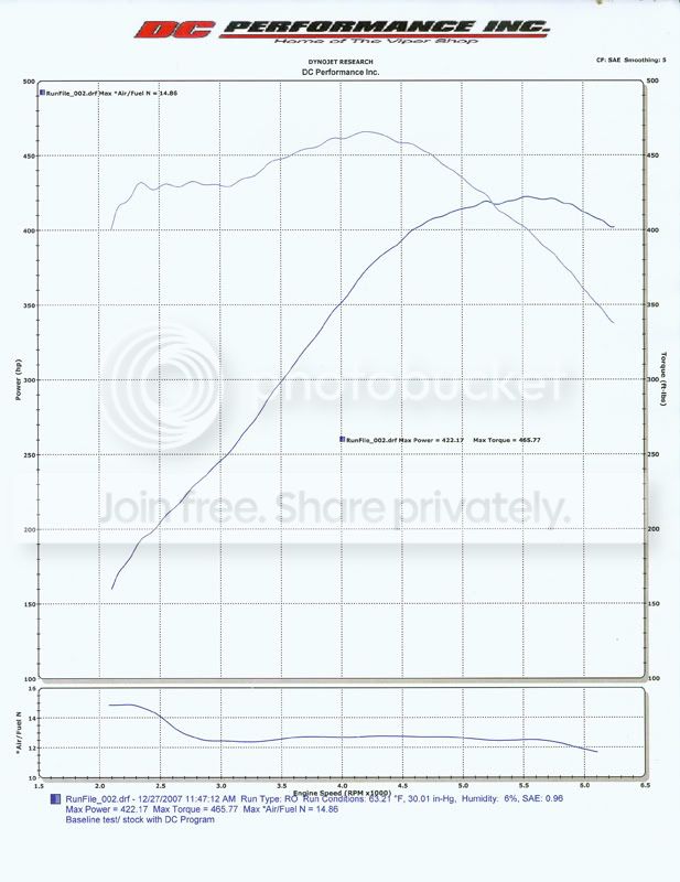

Here are the charts: (All Charts SAE Corrected)
Baseline: (91 Octane Unleaded Gas)
(DC 91 Tune, 170 T Stat, JMB CAI, and Magnaflow CB)
Second Dyno: (91 Octane Unleaded Gas)
Baseline plus Roe TB, Mofo long tube headers and mids.

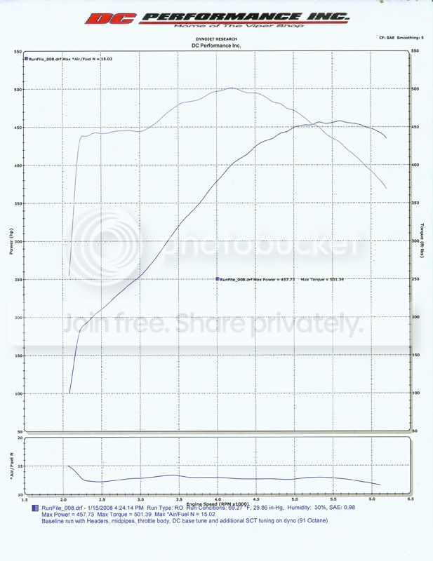

Third Dyno: (91 Octane Unleaded Gas)
Baseline plus 2nd dyno additions and SCT Tuner with Chris custom tune:
Final Dyno: (105 Octane Unleaded Race Gas)
Baseline plus 2nd dyno addition and third dyno additions with 105 Octane Gas and custom tune by Chris:
I was not happy with the gain/loss of the last race tune with 105 octane gas. I was able to only get 3 RWHP gain compared to 91 tune with a 4 torque loss.:dontknow:
Is the octane too high? Is the compression of our engines to low? I just don't understand how 14 octane increase in gas doesn't translate to at least 15-20 RWHP. Anybody got any ideas?
