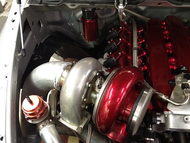

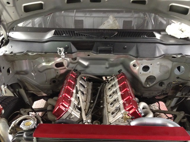

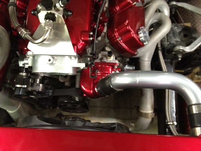

Well its back again for massive weight savings and a new EFI system. Hard to believe it never was intended to be more than a 1000whp street only build almost 5 years ago. Ill post pics of the progress as we go. Goal is street legal, sub 4000 # with driver, same or slightly more power with new EFI system/tune, 8.XX@160+ ET. Judging by my calculations/progress/scaled weights, we will have taken off 600#'s by the time it leaves
Before:
After a few weeks:

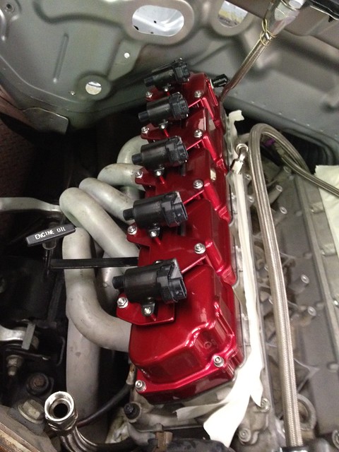

imagine that, coils where you don't have to take the intake off. :D

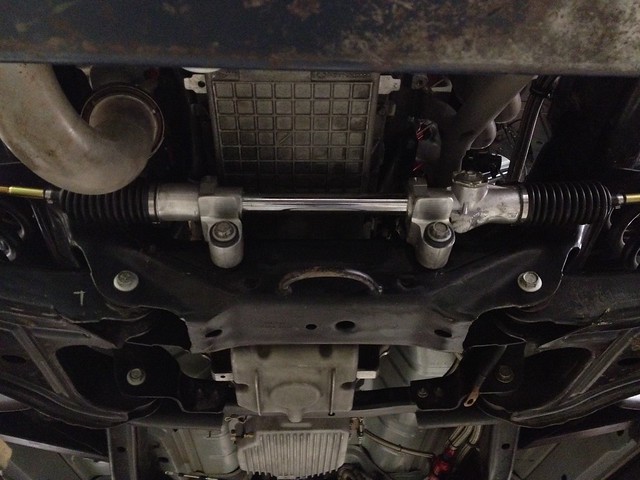

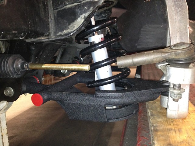

Thanks Guys, heres the weight list so far, I did not scale it before it arrived and its kind of up in the air what the base weight was (supposedly 4200-4400#), but all of these weights are directly from my shipping scale (except the estimated weights at bottom):
Brake booster/master cylinder/abs module 21#
PCM, coils, injectors, wires, vec 16#
All Stereo except wiring 20#
All wiring, aftermarket guages, IC sprayer, meth pump, boost controller etc. 79#
Steering column and wheel 21#
Dash metal structure 24#
Carpet and interior insulation 36#
Heat shields and exterior insulation 8#
All interior plastic and oem guages 70#
Door metal structure 20#
Rest of insulation/dynamat/interior brackets 6#
Oil cooler 7#
headliner/misc interior trim and wiring 22#
Power steering setup 35#
N20 bottles mostly full with bracket 50#
Water injection jug when full 15#
Brakes (rotors/calipers/hubs) 151#
Bogart/Kumho Wheels/tires 113#
5" Exhaust exiting before rear tire 43#
Lower control arms 66#
Xmetal springs 38#
Steering column/pedal mount modifications 2#

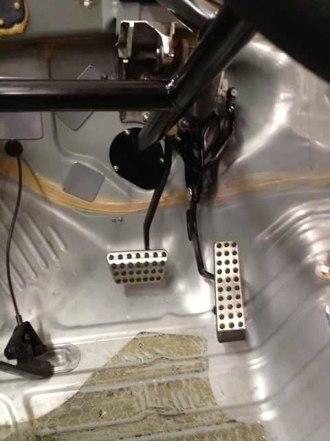

Stock pedals 10#
Still possible weight removal:
Rear crash tube/bumper area
Added:
New front springs 25#
New column and new wheel 8.5#
New steering setup 14#

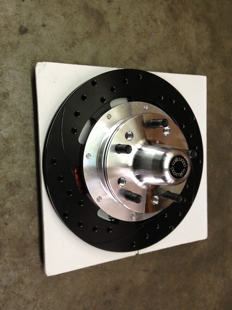

New master cylinder with mount 1.5#
New pedals 5.5#
New lower control arms 55#
New Body wiring harness/relay and fuse panels/switch panel 7#
New exhaust 8#
Adding Estimate:
EFI boxes and engine wiring, injectors, coils, dash display 20#
Interior carpet, door panels, aluminum dash 22#
New wheels/tires 45# (according to manufacturers)
New Brake setup 50# (rotors/calipers 36#)
