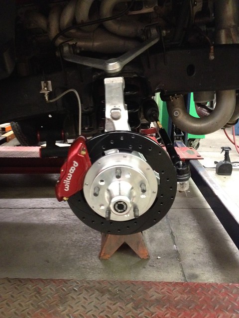

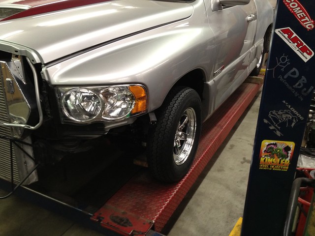

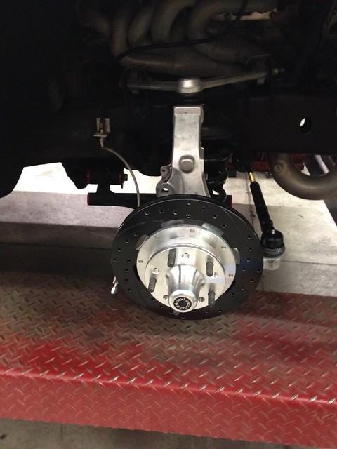

Finally its a roller again!!! Hoping to make the caliper adapters in the next couple days as well as set the final ride height. Ill rescale to get the front/rear weight distribution and a more accurate weight. Last weigh in was 3600#'s as you see in the pics plus all the seats, carpet, wheels/tires, brakes, etc. all on the scales (basically only missing fascias, tailgate, sheet aluminum tonneau cover, and engine management). Ill be scaling a Procharged RC Ram SRT10 also to compare to BTW. Second pic shows how light his truck has gotten, it has a 2" drop control arm and a much lighter than stock spring and it still sits that tall in the front!
Justin
