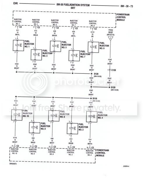

In other words there is a short somewhere in your harness for injector 1. Could be in the clip that goes on the injector, or down where #1 of the harness goes into the rest. And very very worst case scenerio(which i do not personally think) Ecm is fugged. But more than likey it is a short in the harnes on 1. when you pull back into the drive way, leave the truck running. If you dont have a meter a test light will work. If you have a meter check for continuity on the injector harness if your getting continuity you have a short in that harness.No meter and just a test light. Get a paper clip straighten one side so you can put it in the harness and clip the ground end on, then check it if the light does not come on you have a short.TREKER said:Well, ran the seafoam through this morning. Sucker didn't even smoke one bit, nothing. Engine light still on, took for spin around block. No smoke, but as soon as I turned right, it started the same thing again until I let off gas and drove straight. But it still has a miss to it. At idle, it's fine.
Any ideas on what a injector circuit is?
