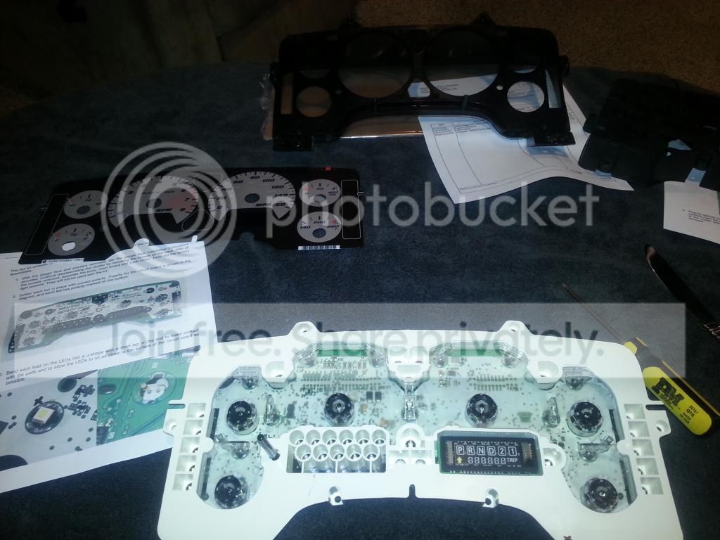

Spent most of today working on this little en devour...
The tear down...and YES I used the instructions for this project! lol

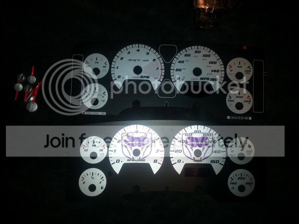

....from stock to SSSSsssinister...

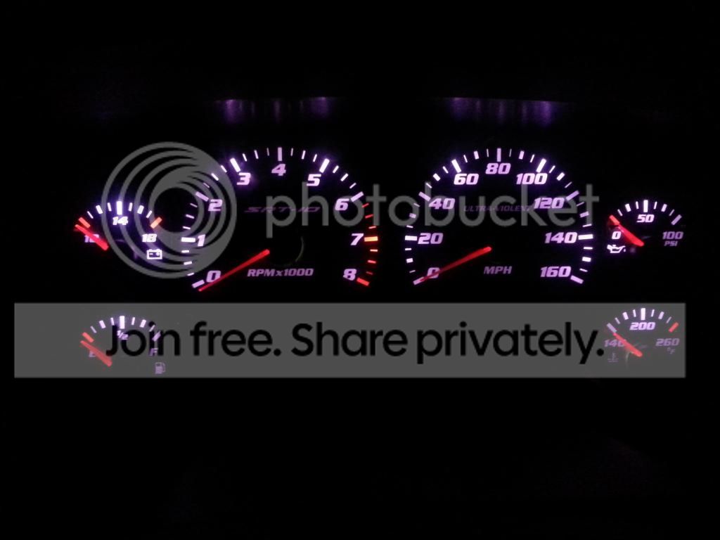

Install complete...
What I didn't get pics of was the sweat pouring down my face as I had to replace the stock incandescent bulb sockets and solder in 11 new L.E.D.s that was the part of the modification that had me the most nervous, but ended up being really easy.
Last thing to do is have the gauges recalibrated at the dealership on Friday...
