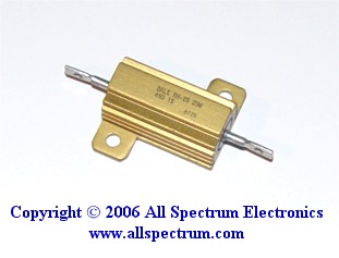

any hints? looks like 6Ohm resistors would do the job, but they draw some high current and get hot! 50 or 100 w aluminum resistors are needed.
like this one
