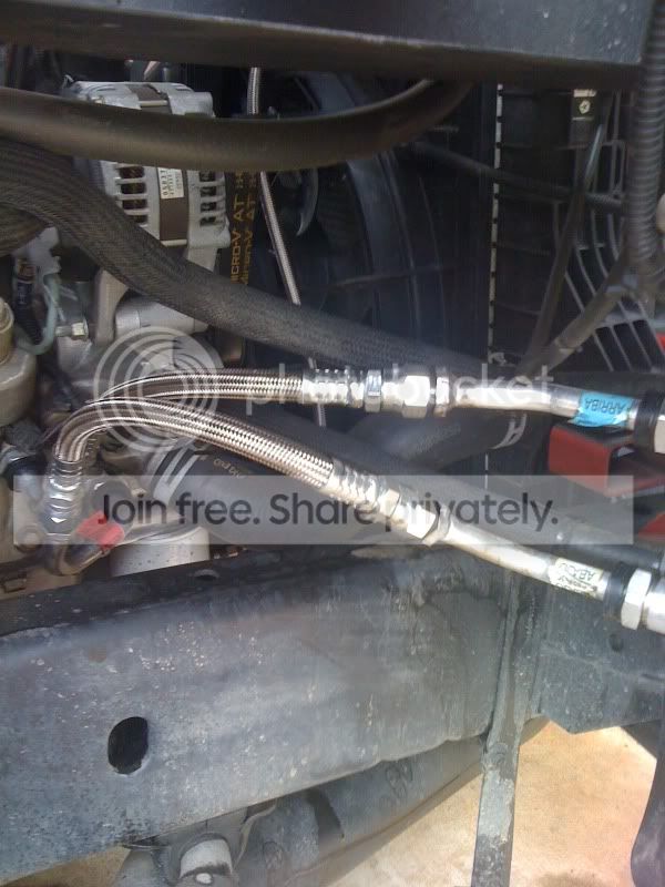

since we're on the subject... this is what i did and don't have any leaks and 60k miles on these lines (110k on the truck now)
i didn't know who tony was when i was having problems... or barely did...
cost me $90 and i reused my oem quick disconnects... welded AN bungs to the oem quick disconnects and with 3500 lb. braided lines and aluminum AN fittings i haven't had an issue...
but i do have his PS lines...
