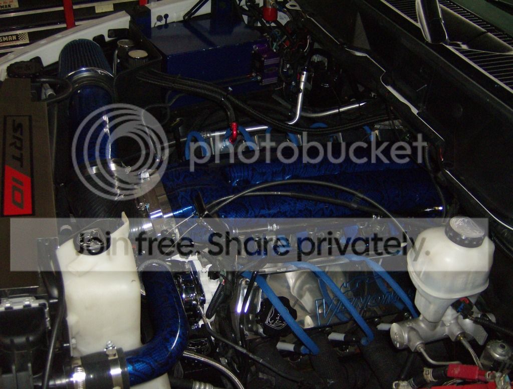

Just got to wait on T-MAN to tune it for me:(,Runs and has a nice thumpitie thump with the roe 710 cam and striker heads ,and slow bleed lifters.
This is what was done this time
had a time figuring out compression ,finally got it according to math 10.72 to 1 ,had to get a special set of head gaskets because my strikers are 72 cc but its all good now!:rock:
and slapped a roe 710 cam in it ,had a stage 2 crower cam and was at 10.3 to 1 compression ,and on a dyno N/A was at 575hp/576tq with a remote Torrie tune
The roe cam has a higher lift than crower so hoping for a tad more than the crower put out
I also put on Tony's TB
Also have Dan the pregnant man's built trans now and a brand new Tony gen 2 shifter and trans shifts smooth as my A$$ now lol
