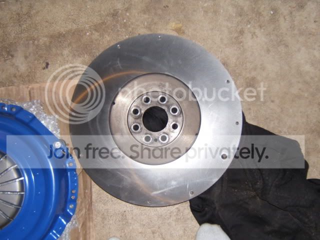

Resurfacing a flywheel and turning a flywheel are different. Resurfacing should only take out the scuff marks(unless it is warped). The pic is of a resurfaced flywheel still at specs. If your gonna buy a new one Sean sells them for 130 bucks plus I think I paid 15bucks for shipping had it in 2 days.
When I find where I put the specs for minimum thickness I'll put it up.
If it is warped by all means it is better to replace it.
