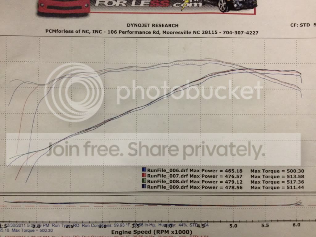

When we got the truck we did a test drive, plus a before dyno, on the before we ended up on an average of 417 rwhp .
From there we installed the mopar cam, headers, cat back,harland sharp rockers, hardened push rods, valve springs, jtsvp coils, wires, new plugs, and our TB, no tuning was done at this point as the customer wanted to use the mopar performance pcm.
the end result was a nice simple 60 hp gain, that makes the truck a blast to drive! trq is everywhere, tire spinnage now is at will. The throttle is super smooth, and drives jsut as good as the day it came off the line, only iwht a touch more exhaust idle burbage.There was no tuning, but I feel with some unleashed tuning love it could easily tweak out a few more hp.
the first dyno sheet shows the final result, the second dyno sheet shows stock hp and hp with our new jtsvp billet tb
