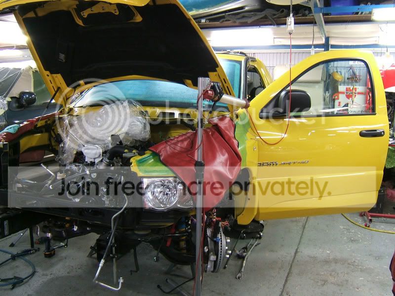

Thanks guys. :) Yup, the manufacture and duplicated a reverse dash and setup from scratch. It's quite amazing really. Obviously no one makes RHD set ups so they really had no choice lol. :D

Holy CRAP, it looks bloody FACTORY!!!! :dontknow: :rock: :D That '06 interior is growing on me... it REALLY looks good, even backwards. :)

They did a hell of a job with your truck.
Never thought that it was possible with a LHD Viper truck. Very nice work :top:

Looks like they did a great job on the new drivers floor pan - made of stamped steel? Mine is made of carbon fibre, hows the room on the drivers footwell? Mine is a little cramped, still doesnt feel factory but i guess its the best you can get with the amount of room available.
Did they give you back a foot brake? i have a handbrake located on the transmission hump, i know, but it does look factory.
Also wondering - why the need to remove the transmission? Im pretty sure my engine was shifted an inch to the left but the trans didnt come out.
Is the dash plastic or fiberglass - it looks great!

Yeah, mine has a "hollow" near the clutch where they pushed the floor pan down to suit the pedal setup (I'm guessing) so now the carpet has a "air pocket". I'm getting that fixed though. Also, because of this hollow my long tube headers didn't fit because under the floor pan is now around 2-3" towards the ground over factory, the header flange hits it, where as if it were factory it would have slide just under it. I'm having the headers altered buy a custom tig welder in my area, goes in tomorrow actually - cool!

Nope, no handbrake. I have a foot brake but a handbrake would be good as well, make life a little easier. The foot brake is to the left of the clutch pedal and is roughly 3-1/2" away from my clutch pedal, snug, but you'd have to be drunk to hit it lol.

Good question and well noted. I purchased a Viper master slave & cylinder upgrade kit which also comes with the Centerforce clutch. They also resurfaced my flywheel while the trans was out. :)
